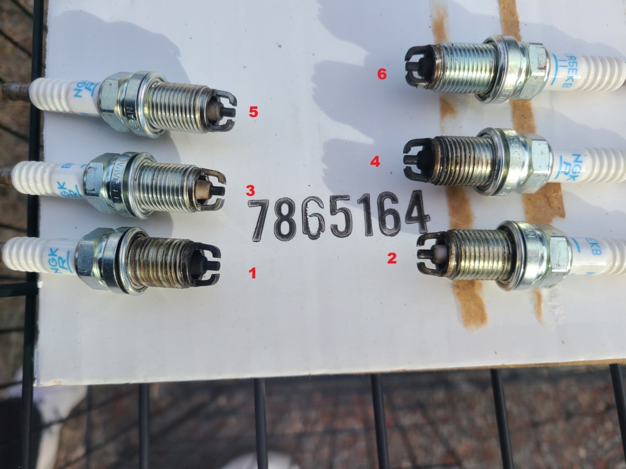

    Been working on this truck that I have no history of. According to OBD2 scan, misfires on cylinder 1, 5 and 6. Changed plugs and wires yesterday, no change. Ohm tested coils and got acceptable readings on all 3. Decided to do a compression test on the cylinders. Took all the spark plugs out, and noticed that several of them were already quite black on the ends. The motor only ran for about 3 minutes on the new plugs before I shut it off yesterday.

    Good investigative work. I wonder what caused the carbon fouling on the plugs from 1, 4 and 6.

    I'm leaning towards bad/old gas. I don't know much history of it but I do know that the PO bought it from another person where it had been sitting for approximately 4 years. He put more gas in it but that was 6 months ago now. I'm betting the injectors are sticking/leaking causing a rich condition. When I smell the tip of the fouled plugs they smell like stale gas as well. I'm wondering if the sitting for years has something to do with the stuck valve as well.
