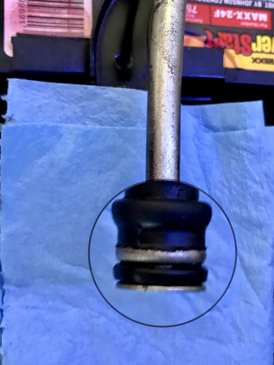

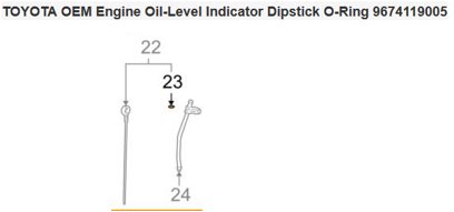

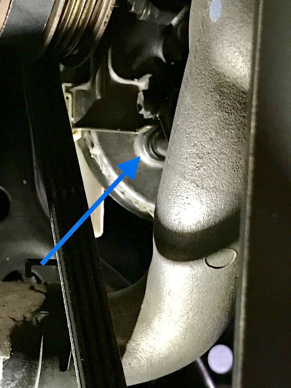

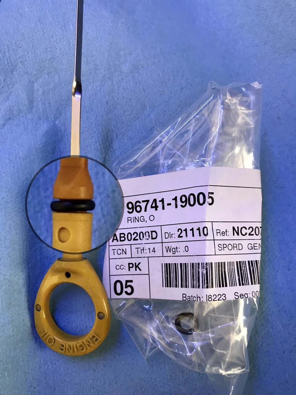

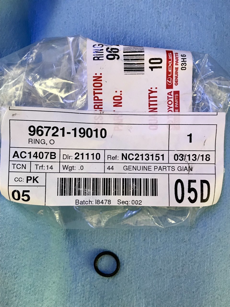

    74298404-755A-43A9-B956-024403EAFF06.jpg 5508C1A0-CD3B-4152-A512-AB88260E472F.jpg 2461AFAA-5C90-458C-BFEF-8EFD0E268BA2.jpg AFA6930B-3BF6-428C-AE5A-48068F17D08B.jpg Update...changed out the o-ring at bottom of oil dipstick tube and the small o-ring on dipstick.
    Just remove the 10mm bolt that secures the dipstick and pull up to remove.

    that works thanks for the pictures got to change my also .

    Thx for the pics, explains everything
