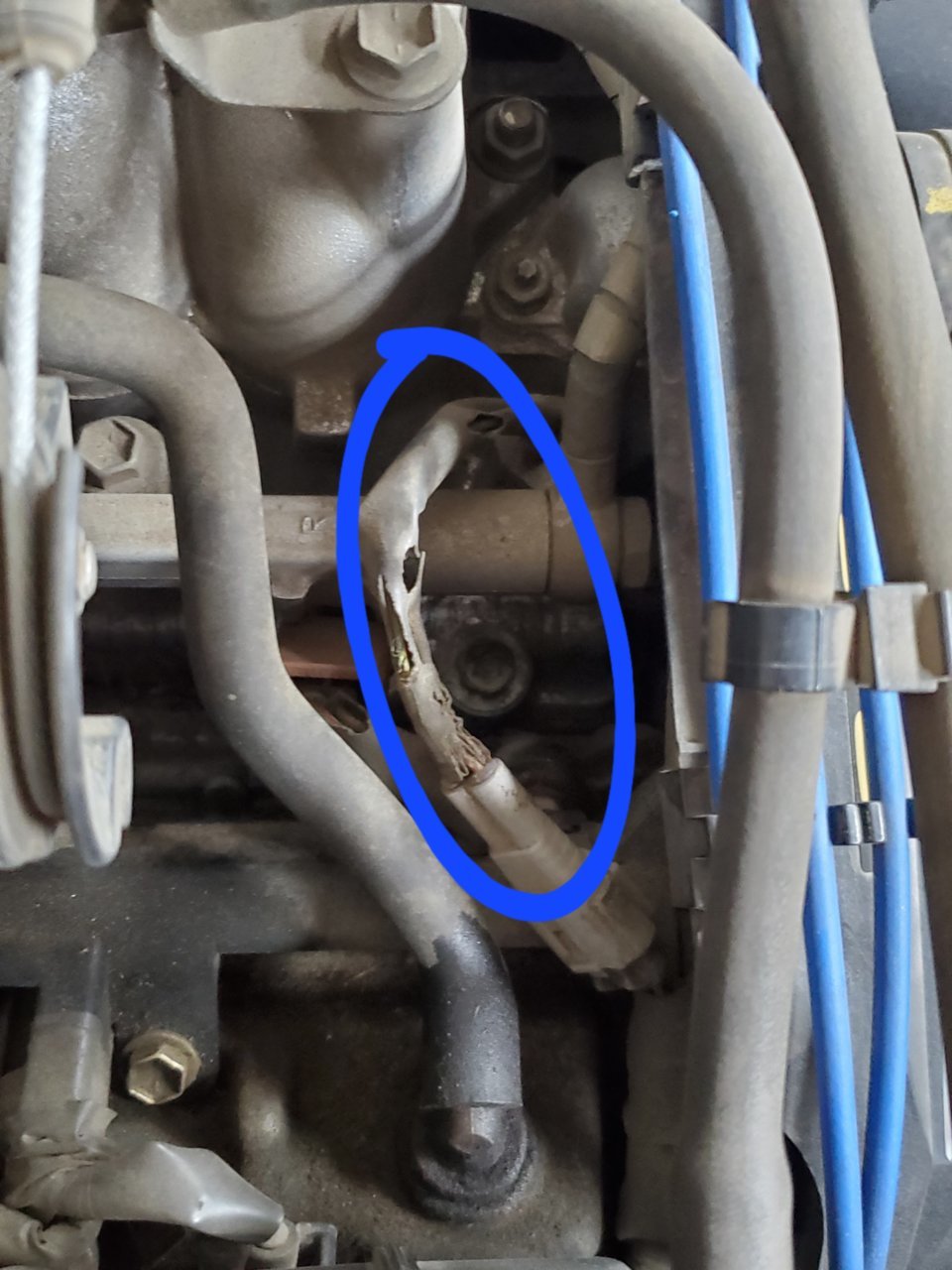

    My PCV looks like it may need to be replaced as well, and then I found this problem right next to it. Do you guys know what this wiring is? 20230419_163414.jpg

    I'm thinking knock sensor harness although I could be completely wrong. And if I am, I hope somebody else chimes in with the correct answer.

    I'm thinking it's the engine coolant temperature sensor wiring but I'm not having problems with coolant temp

    Engine coolant temp

    If you have the pigtail style (connector at the harness and sensor with a short piece of wire in between), you want part 82219-34020.
