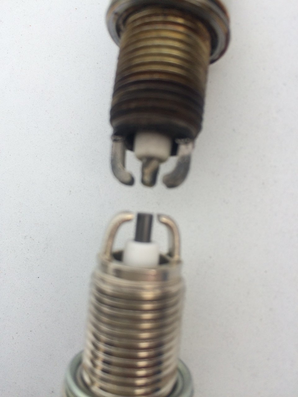

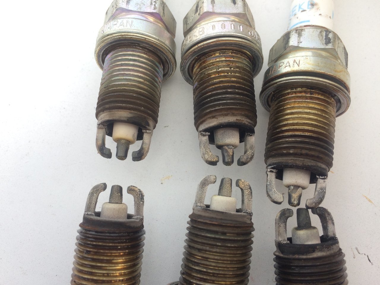

    Dual electrode Denso and NGK from factory yes, single electrode no.
    The "most" likely reason for the factory mix is a business practice known as "Vendor Management" and the fact that Toyota owns a huge chunk of both Denso and NGK. There are no performance, operational or assembly theories that hold any water.
    There are a couple things to note on "reading" these plugs. The NGKs from the factory and even some from aftermarket sources came "pre gapped" wrong. For a time NGK even listed the gap wrong, much smaller than the Toyota spec that the Densos came properly set with. IIRC it (NGK) was something like .023" with Toyota spec at .043".
    In addition one side of the 3.4 fires center to ground while the other side fires ground to center. This can contribute to the perceived erosion and promote a bit of false "brand loyalty".
    Below are the factory plugs form my truck at 30K. The Densos show a larger gap and much more erosion on the center electrode.
