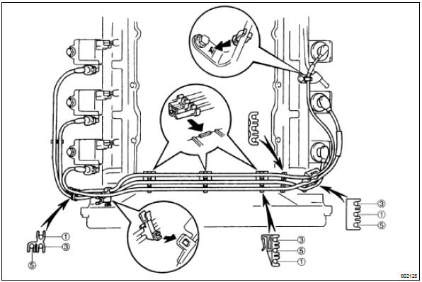

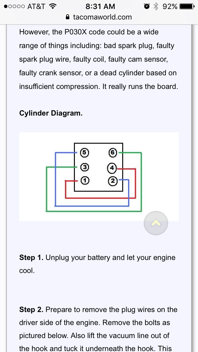

  7. Dec 2, 2017 at 11:05 AM
    #27
    Dirty Pool
    Dirty Pool FLIES ON THE FRIES, KETCHUPS WATERED DOWN
    Mar 24, 2013
    #100471
    2,317
    59.4 Miles, 56.67° NE Of Moab
    99 XCAB V6 MT TRD
    Dirty Pool rear bumper/air tank with integrated spare CV shaft storage, DP customized TJM front bumper, 8000 lb Ramsey/Technora rope, E-locked, Extended breathers with front diff catch can, PCV catch can, SAWs with DP heim joint seals, DP custom 6 leaf rear springs/Billies, DP custom skids, 2lo, Gray wire, Cap, Bed Rug, Black steelies, 01 Center console, Map lights, Disraeli gears
    And route the wires like this. The specific placement and crisscrossing is intentional.

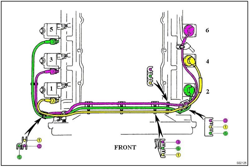

  10. Dec 2, 2017 at 3:35 PM
    #30
    ThunderOne
    ThunderOne Well-Known Member
    May 20, 2009
    #17473
    10,042
    Mitchell
    Nashville
    1ST GEN OR GTFO
    Toyota NERD
    Another helpful routing pic
    opteron likes this.
