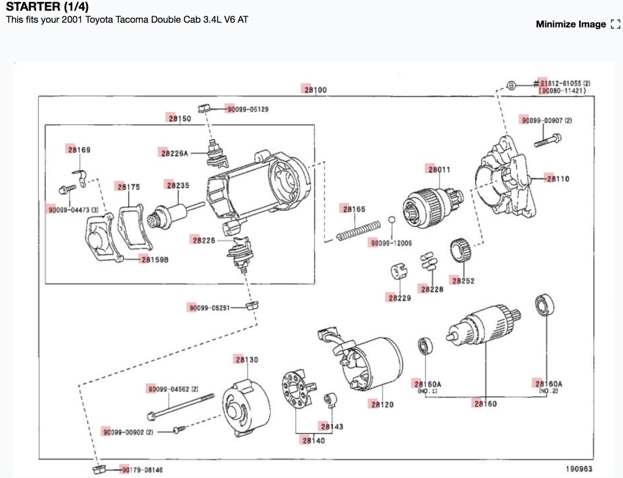

    Does anyone know the part number for the two bolts that mount the starter to the bell housing on a 3.4?? I can’t find anything.

    Where the hell did you find that diagram? Every single one I’ve found doesn’t show the 9009900907. Thanks! Hopefully that’s the one.

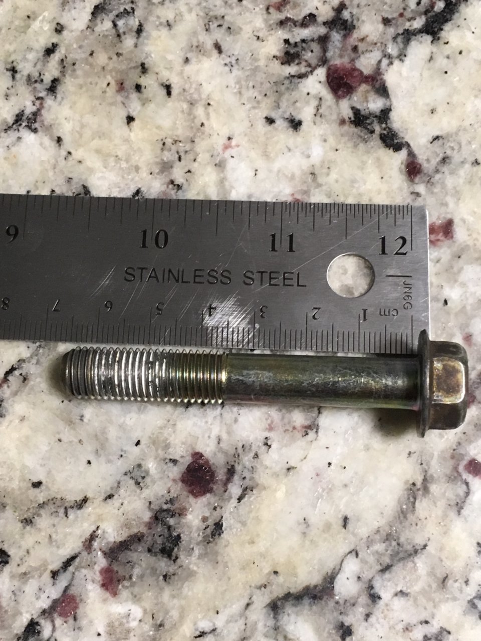

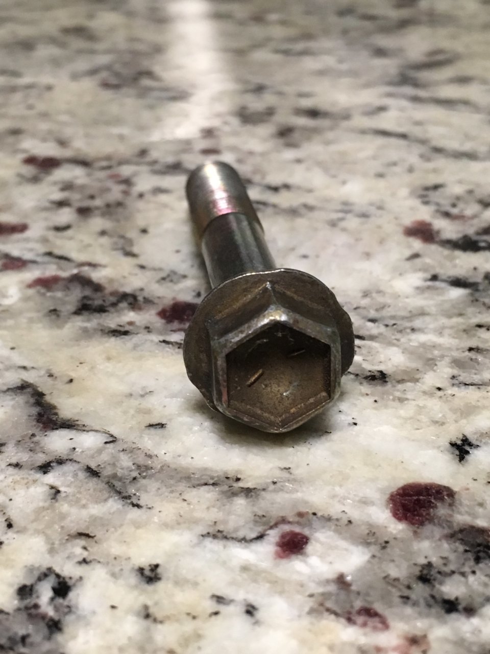

    Post seems dead but, I lost one bolt and one got lose in my 1999 TRD. I just went and bought a 70mm m10x1.25 no need for the specific bolt from Toyota.
