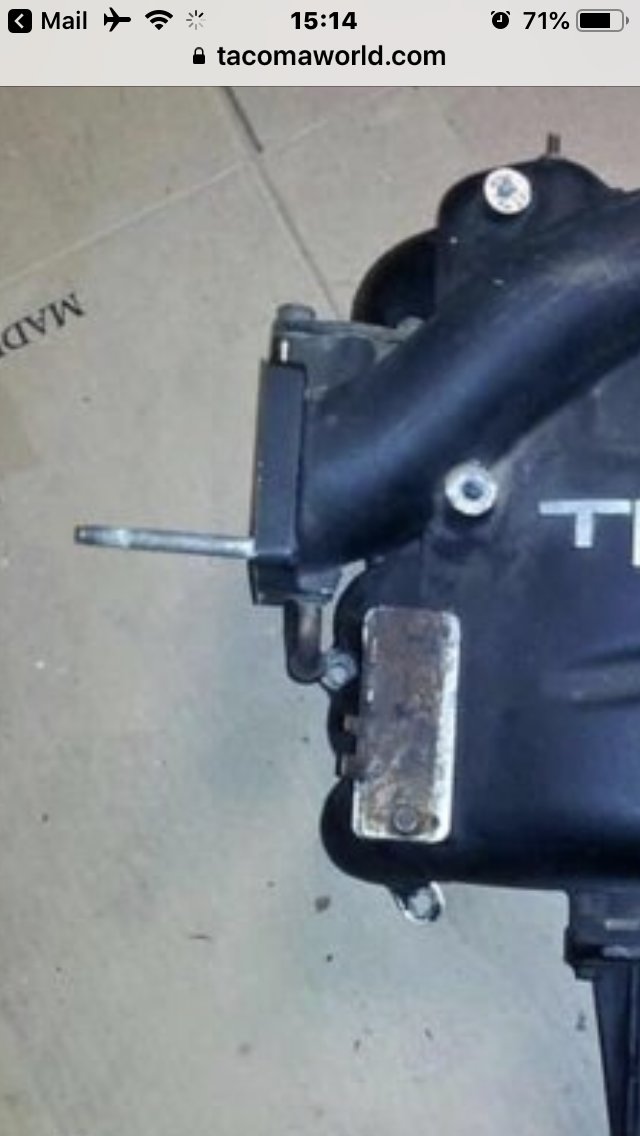

    I’m at sea and not sure the pic will load but could the missing bolt be from here? (Pic stolen from 1st gen for sale section)

    That sure looks like it could be it

    I saw this pic in the for sale section and just looked at his pic about the missing bolt. Not sure how it would cause the code though?

    I doubt it would, but if it's indeed missing from there it should be installed anyway

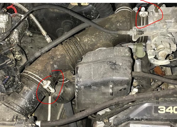

    @QMEDJoe I checked that before and this bolt is a lot smaller. I also thought it might be from the stock air intake boot but although they are very close in size they are not the same. Capture1.jpg
    It almost looks like one of those throttle idle adjust bolts but I cant figure it out. I don't think it has any thing to do with the CEL but Its just killing me that I cant remember where its from, its such a unique bolt and to not have a home for it is very disappointing at the least.
