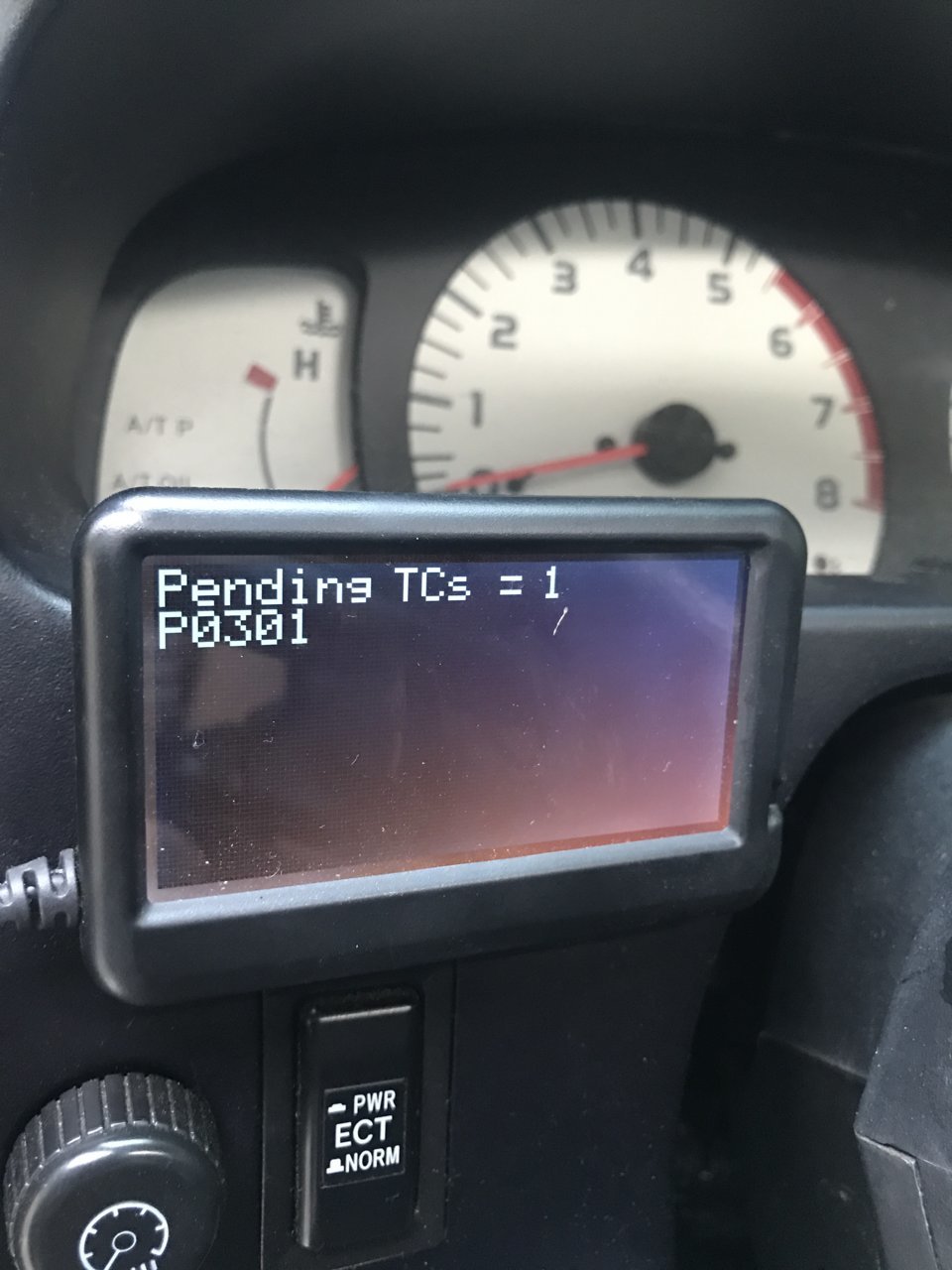

    Thanks guys for all the help. Today I swapped out the bad injector and had to replace one of the other injector seals as one got pinched and started leaking. Back on the road the check engine light is gone. So far so good and do I have to say with the 2.2 pulley, this thing pulls. Now I need to move on to a piggyback and a meth kit to help keep the supercharger nice and cool.

    Ok I think I celebrated to early. Yesterday the truck was running fine all day and today I smell gas again. I think one of the seals is leaking again...
    Is there a special way to install the injectors? I double checked to make sure the seals fit and didn't bind, maybe they moved while I tightened down the bolts?
    I've installed a few different injectors before on different cars and its usually easy and straight forward. not sure if I'm missing something here.

    They are new injectors and I already replaced one of the seal but today I checked the same injector blew out the new seal. It was a little tight going in but I moved it round and made sure it was seated. Is it possible I'm over tightening the fuel rail? Its wired because I moved the injector from cylinder 3 to cylinder 1 and the seal blew on same injector but a different location.
