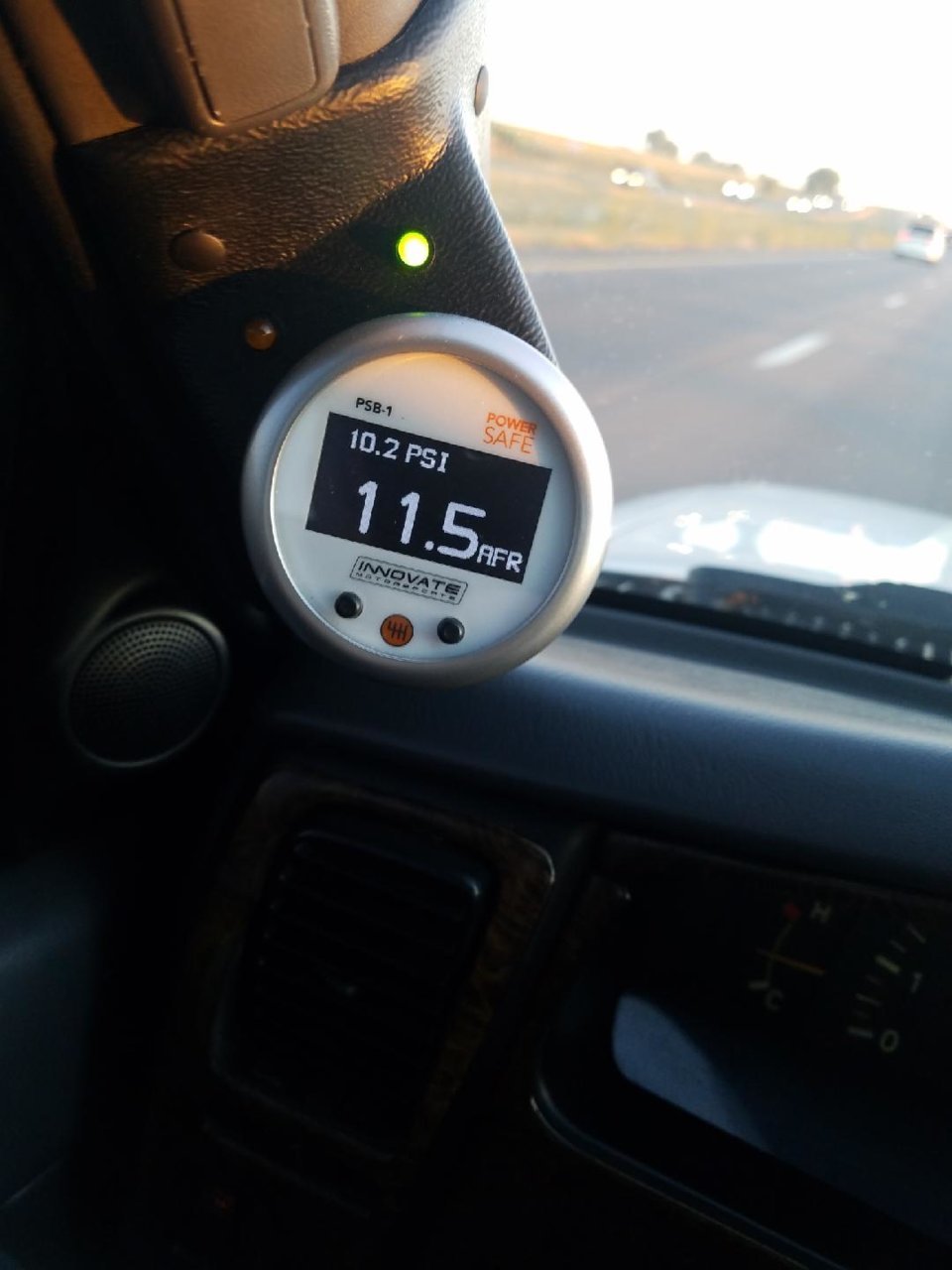

    It's really a super slick gauge you can set the Boost as your primary or only boost or you can do the air fuel ratio as your primary and your Boost secondary or you can just do air fuel ratio there's a lot of different things that it does if you read through the YouTube demonstration on it wish I put this in long time ago, even shows your Peak boost for whenever you've been driving until you shut the truck off and then resets itself.
    You can wire in the shift light that tells you when to shift your gear if you're trying to race somebody I did not wire that part in a light comes on you can set that for 5000 RPMs so you don't have to look at your tachometer

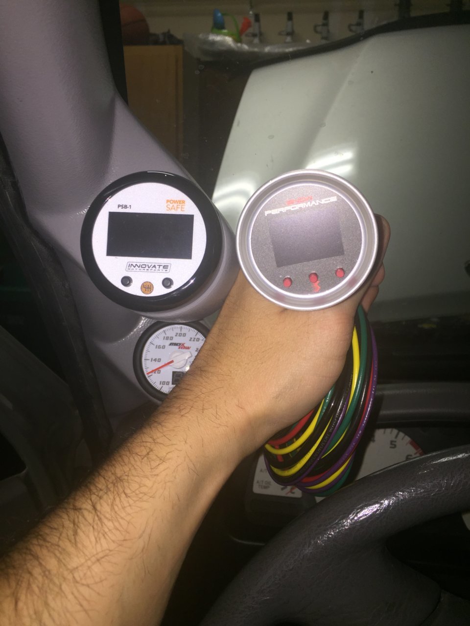

    Did your gauge come with a black screen that you can change out?
    Im looking at this gauge from Prosport but don't know if its any good: https://01f6bbb.netsolstores.com/wideband-air-fuel-ratio-kit-and-boost.aspx
    Also what pilled pod did you go with? is that the one from Amazon?
    https://www.amazon.com/Auto-Meter-15411-Gauge-Works/dp/B00062ZWAU
  13. Sep 16, 2019 at 4:44 PM
    #93
    1997tacomav6
    1997tacomav6 V6 5sp,RegCab,TVS1320 Supercharger,Haltech, 800k
    Oct 5, 2013
    #113940
    10,386
    John
    Denver
    97 reg cab, v6 5sp 300hp supercharged, Methonal Injection, 800,001 plus miles, Original Owner
    V6 5sp,RegCab,TVS1320 Supercharger, 56mm pulley, methanol injected Haltech ECU, AC Tvs1320 supercharger,(MUST DO) every 125,000- 150,000 needs rebuild Projector headlights HID 5 speed manual Amsoil for all drive train Smaller 56mm custom pulley, (MUST DO) 2004 DESNO fuel injectors, zero ping ping, 2004 side door mirrors Dick Cepek Rims, Michelin tires LTX, ATM Pathfinders Dynopro ATM ( that last 100,000 miles) Now running Dynopro ATM mud and snow tires KN cold air intake Cat back dual exhaust with ss exhaust tip, Raised exhaust tail pipe to 2" below body line Optima*dry cell battery,red top Alpine sirius radio, 200 watt amp, focal is165 split door pod speakers Focal door speakers Subwoffer behind seat Viper alarm, Electric Locks Dark tinted windows, bucket seats corbeau lg1 Tacoma Rubber floor mats TRD fender extenders, Bilstien shocks, King shocks JBA UCA trailer iv hitch, electric brake control, Drilled slotted brakes, High carbon steel (MUST DO) EBS green stuff 7000 series pads(MUST DO) TRD engine oil cap TRD stick shift, Marlin crawl shift kit. Rear sliding window 2002 4Runner functional hood scoop cut into Tacoma hood, 4Runner dual overhead map light Gentex Auto dim + Compass + Temp, garage,rearview mirror Snow Methonal kit stage 2 Custom 3 core aluminum radiator Linex bed liner Haltech stand alone ECU, Intake supercharger gauge. Stainless steel brake lines, Custom leather wrapped steering wheel, Haltech stand-alone ECU,
    My face choices were black or white if I remember
    The maker of my gauge is very very well-known and they make top quality gauges
    I bought my pot off eBay, remember there's two ponds types one for the early Tacoma and one for the later Tacoma

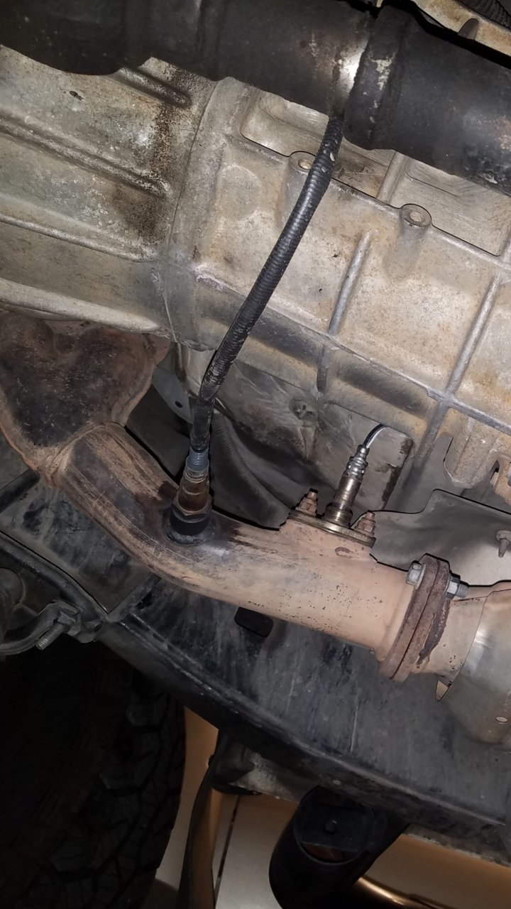

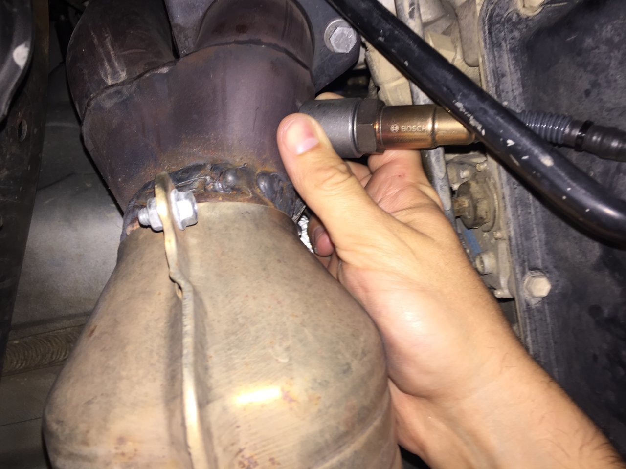

    Went with the Innovate Motorsports 3892 PSB-1. Now to weld the O2 bug in place.
    @1997tacomav6 or @eon_blue Do you guys by any chance have a picture of where the 02 sensor is mounted on the exhaust?
    1997tacomav6 likes this.
  15. Sep 23, 2019 at 6:02 PM
    #95
    eon_blue
    Mar 4, 2016
    #180213
    69,762
    Azusa, CA
    I can grab one for you later but it's after the headers and before the 1st cat. Only a small area there that it can go on. The guy that did mine said you can drill it into the headers but he doesn't recommend that.

    @Rldanie just installed this gauge and has header and two cats.
    So he has a good photo probably for you if you have two cats
  18. Sep 23, 2019 at 7:49 PM
    #98
    Rldanie
    Rldanie Punisher78
    Jan 28, 2018
    #242763
    829
    Colorado
    2002 Supercharged, 2” pulley, FIC, Methanol, Transgo Shift Kit
    Engine Performance upgrades: Supercharged (Magnuson) FIC/6 Champion Radiator Toyota Corolla thermostat 168° JBA Headers JBA cat back exhaust Upgraded fuel pump Volant Cold Air Intake With custom plexiglass cover TransGo Transmission A340F Valve Body upgrade B&M Transmission cooler Methanol Injection 2 inch pulley Future Plans Supra Injectors Light weight crankshaft pulley Leather seats Off-road upgrades 3” rough country lift 33x12.5” Dick Cepeks Other upgrades: JL Audio 12W6 Sub in custom box JL Audio C5 Mids and tweets all the way around Sound dampened whole cab Transmission temp sensor Gen Tex rear view mirror (temp and compass) Blue instrument panel, a/c control panel lights, shifter, ashtray, glove box. Blacked out badges Blackout bumpers and grill MariMoto Projectors with demon eyes LED Taillights Second generation leather steering wheel with audio controls Custom leather wrapped automatic transmission shifter 3rd gen 4 Runner key ring light (blue) 3rd gen 4 Runner hood scoop
    7A5F5158-FEF8-4E4F-99BA-0517069D652E.jpg 45EE02A3-CF7F-414B-B3BE-16FB60C2FEC9.jpg
    Here
    BlackPearl[OP] likes this.

    Heads up
    The new Snow Methanol kits come with a boost gauge in the controller, good luck finding one likehttps://www.tacomaworld.com/members/113940/ I tried to order one 3 times from 3 different vendors. They all refunded my money stating “out of stock”. This is because most vendors just ship it from Snow. If you are lucky, you might find someone on eBay that has one in their inventory.
    The control has changed from a rectangle control (see John’s) to this round standard gauge style one:
