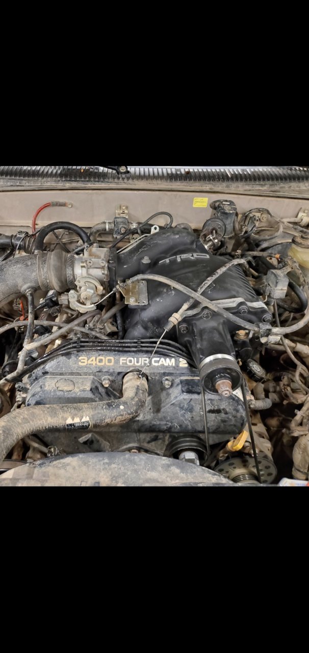

    Hey guys so I recently installed a grey first gen supercharger . In the recent weeks I got lean bank 1 code, the sc has a constant squeal to it that doesn’t stop until I’m the gas. Also occasionally my transmission shifts a little late. Any help would be greatly appreciated
    I already checked my vac lines and clean maf still no luck

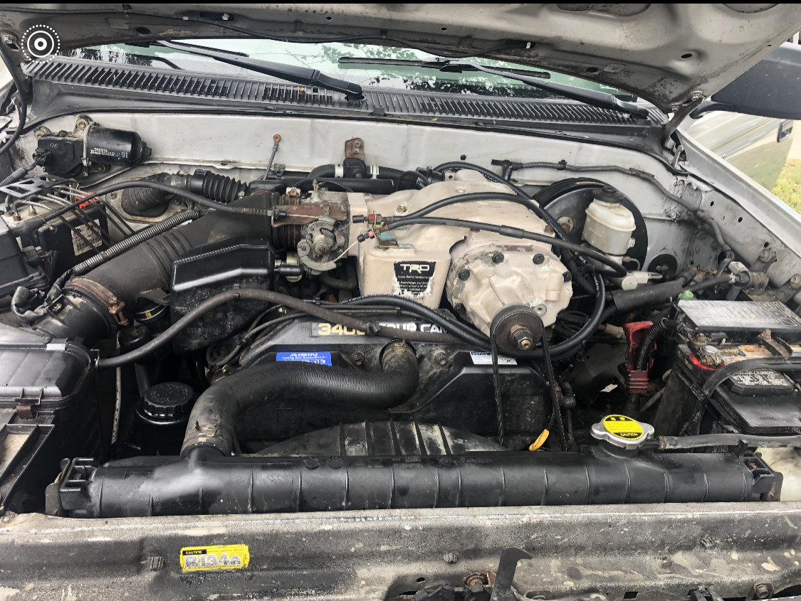

    Here is my kick down bracket. I pulled the cable all the way then made a little bracket to hold it in the position at all times. This keeps the line pressure at maximum, to help prevent the clutches from slipping. It has worked quite well for me with no issues so far. I do also have the largest B&m transmission cooler they sell. This keeps the fluid temps in check. It has been this way for 1.5 years, supercharged (6 psi), twin charged (13 psi) and just turbo (11psi). I can spin the 35" tires on the asphalt and beat on it all day in the desert with no problem. 20201028_195531.jpg

    The dynamic tensioner , I’ll tighten up the cable tomorrow and post some better pics . Currently this is the only one I have

    Sweet turbo set up man ! Thanks for all your help so far !

    That pic shows you have slop in the KD cable. That is not good. The cable isn't even being pulled for 25 or so % of throttle input. You have more power now with less pressure holding the clutches. Tighten that asap.

    I just cut, bent and welded aluminum plate I had laying around. You could do this out of steel as well. Or even use zip ties, I did that for awhile until I finally stopped being lazy and made a bracket.
    You can see the KD cable zip tied to the radiator hose clamp. Haha, function over form!
