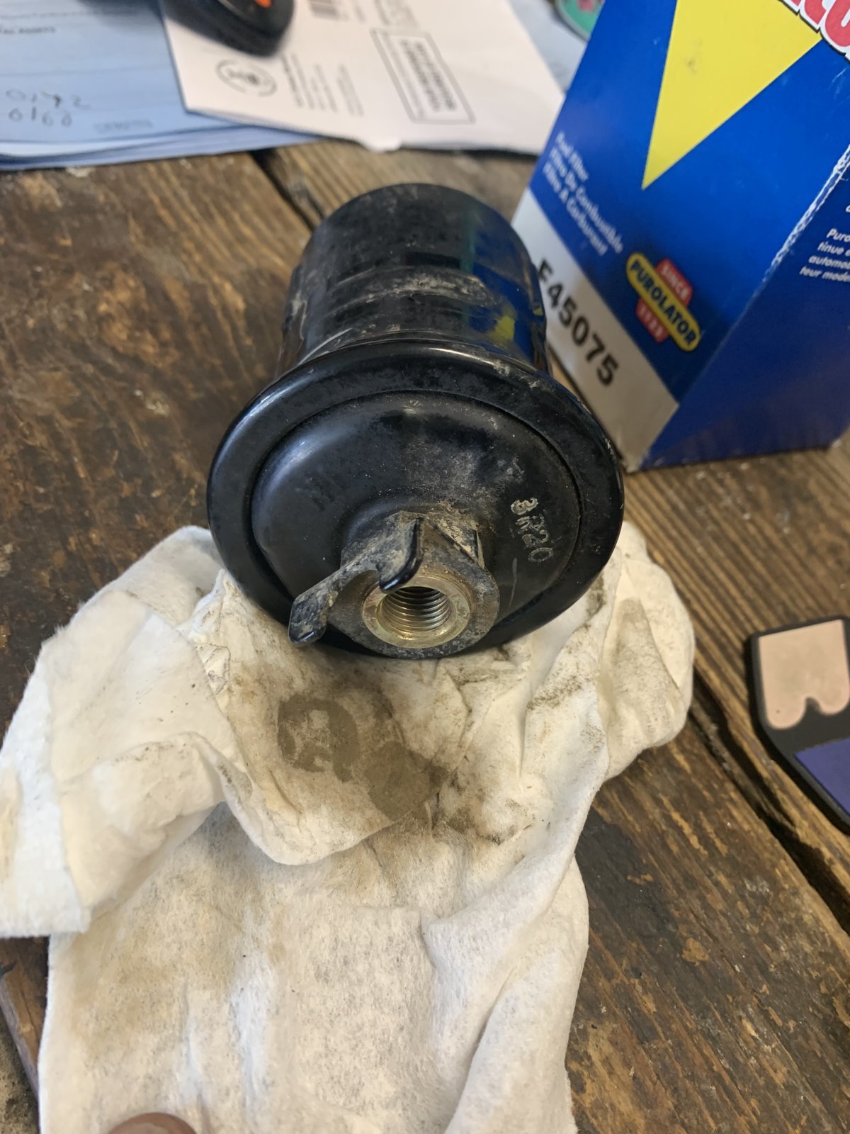

    Cruising in 5th in my 1997 T100 3.4 5 speed, and suddenly have no engine power. Soon as I pushed the clutch in it died, so I pulled over. On the side of the road it would crank no start, maybe a slight stumble. I cleaned the MAF, got a buddy to bring me a crank position sensor because I thought maybe that was the issue but it didn’t help. Pulled the fuel like off after the filter and it had lots of flow when cranking. Pulled a plug and it wasn’t wet but pretty black with carbon. After a couple hours it’s started to stumble a little bit more now but unpredictablbly dies with throttle. No codes or cel this whole time.
    Got the truck trailered home and have been working on it since. Swapped maf with a buddies truck, made no difference. All plugs have strong spark (although seems to only be once the engine starts to stumble on the other cylinders ?) but are pretty black with carbon but not wet. Cracked a banjo bolt on the fuel rail and lots of gas came out when cranking. No fuel coming out of the return line from fuel pressure regulator, whereas my friends truck had lots coming out. Made me thing fuel pump wasn’t pushing enough pressure, so I put a new pump in and for a couple minutes I thought it was running normally. Then shut it off, and when i started it next, was only stumbling again. Any ideas ? i’m lost

    A plugged fuel filter would let some gas go through but not enough on demand.
    Fuel issues = fuel pump, fuel filter, fuel pressure regulator,
    Fuel pump doesn't start until truck is turningover I believe,
    you need 42 pounds of fuel pressure

    I bypassed the filter to check if it was the issue but didn’t make a difference. I am thinking regulator, but if the regulator was bad wouldn’t it be letting too much fuel bypass?. Or I might have a blockage in a line between filter and the motor but not sure how to check that or if i can blow an air nozzle down the line to try and clear it out

    So did you replace the fuel filter or not?

    I didn’t because my local lordco didn’t have one, but I bypassed it and it didn’t make any difference. Obviously put it back in after a short try with it bypassed

    He said he by-passed the filter and the issue remained.
    So he put the filter back on.
    We need a PSI on fuel pressure when this happens.
