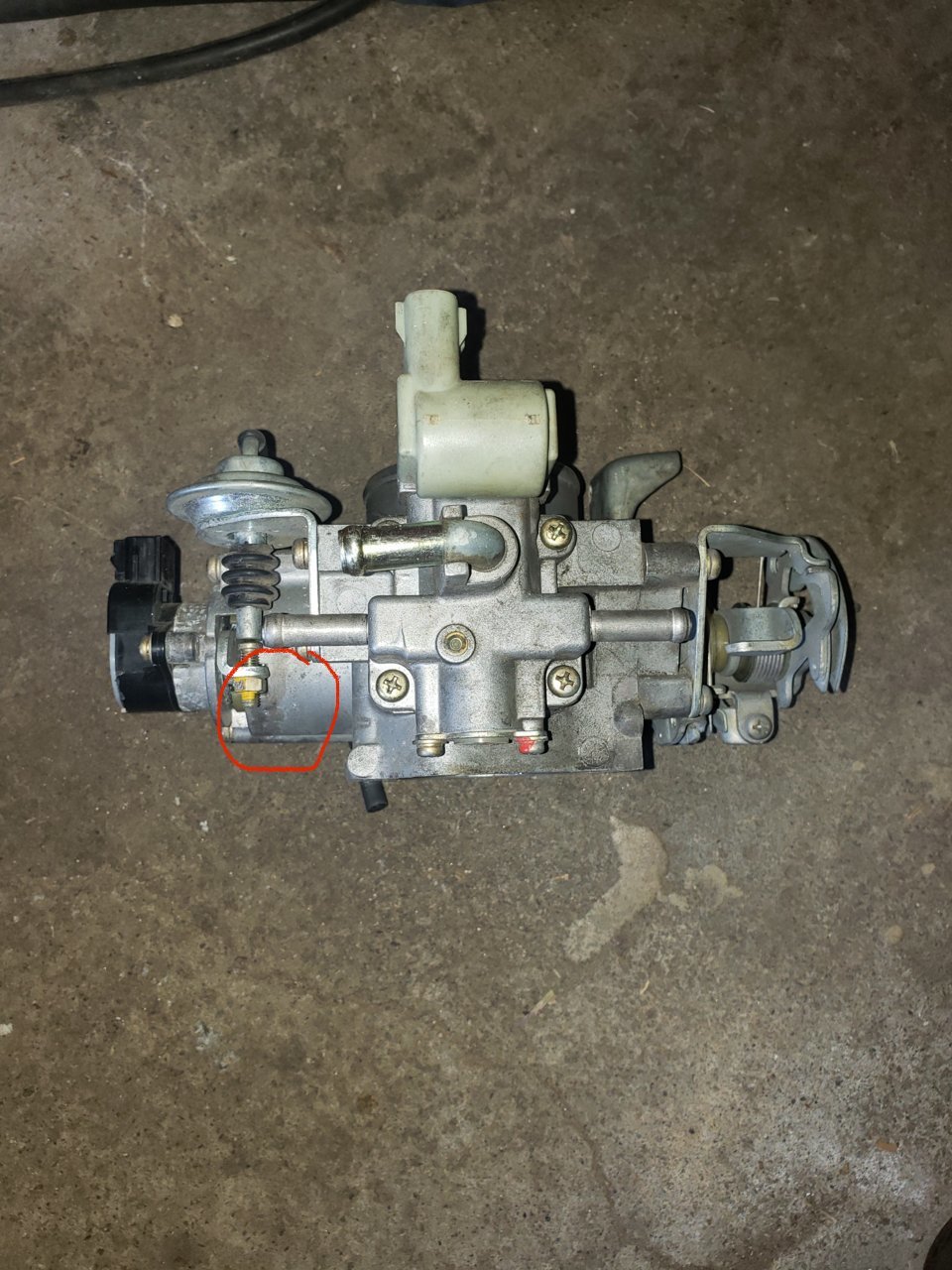

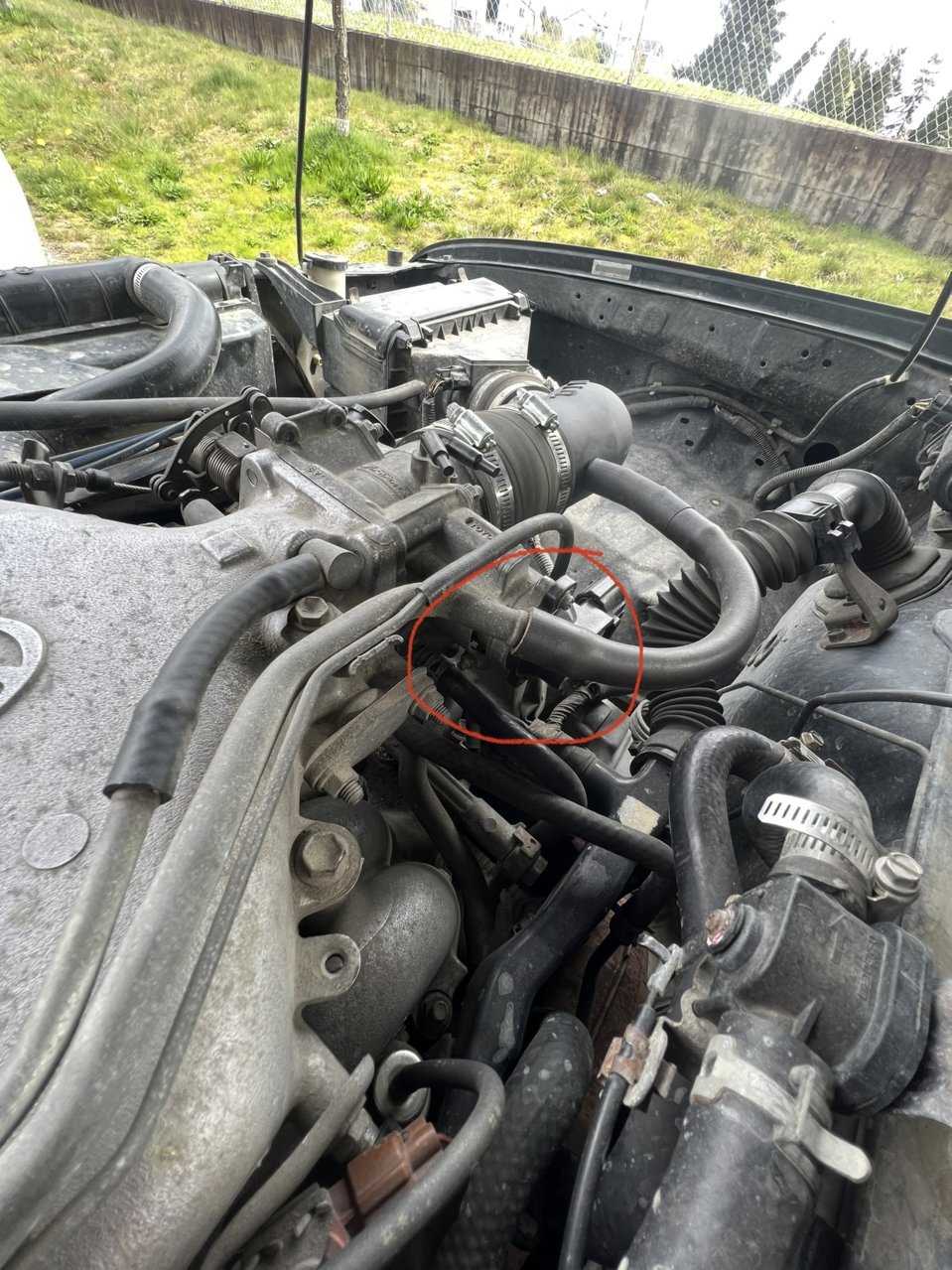

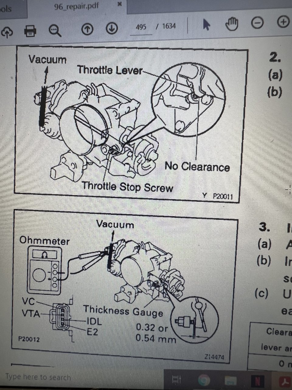

    Does anybody know what this little set screw is for and how to set it? I’m attempting to calibrate a new TPS with the throttle body off the truck. I have the factory service manual but I’m not exactly sure where to put the feeler gauge when rotating the TPS. This truck is a 95 Tacoma with the 3.4 and Manual Transmission.
