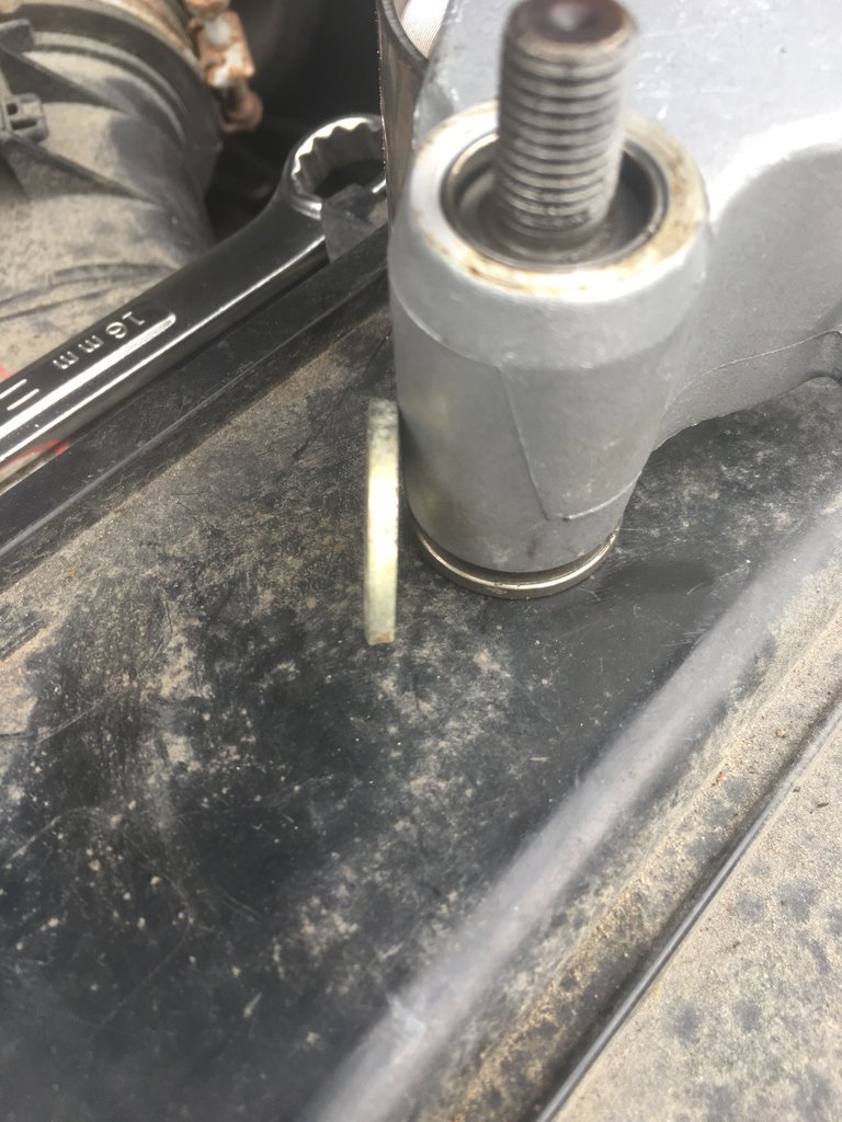

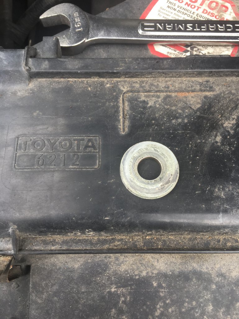

    It's thicker than a standard washer, if I had a micrometer I'd mic it out for you but I don't so hopefully this helps.

    Does it fit the bolt tight on the inside?

    There is very little play in the washer when it's on the bolt, so yes, I would say it's a tight fit.
