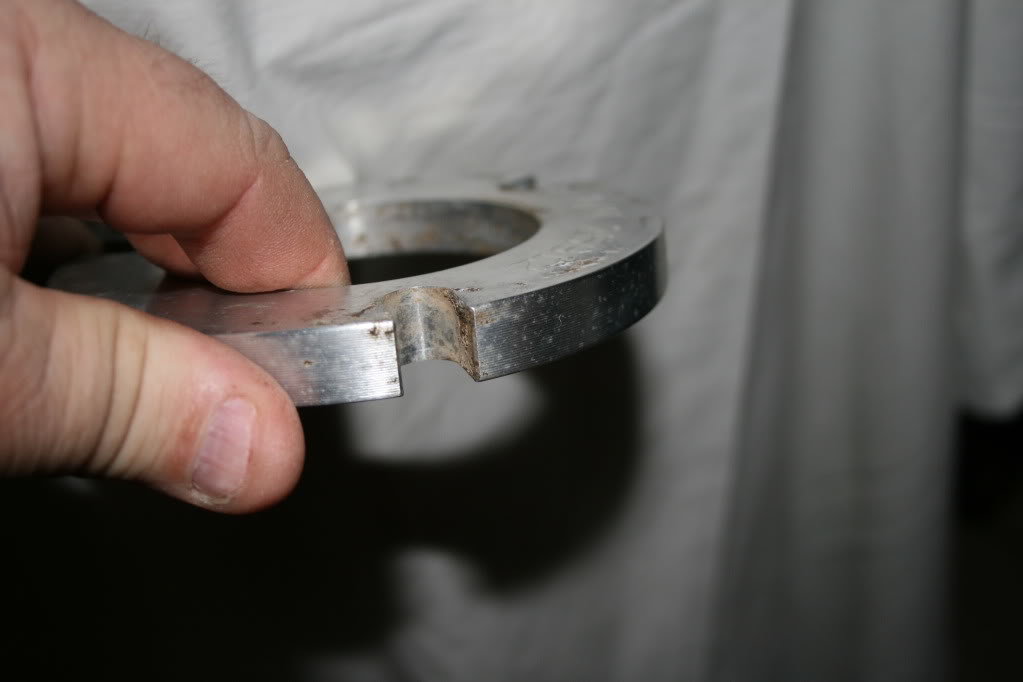

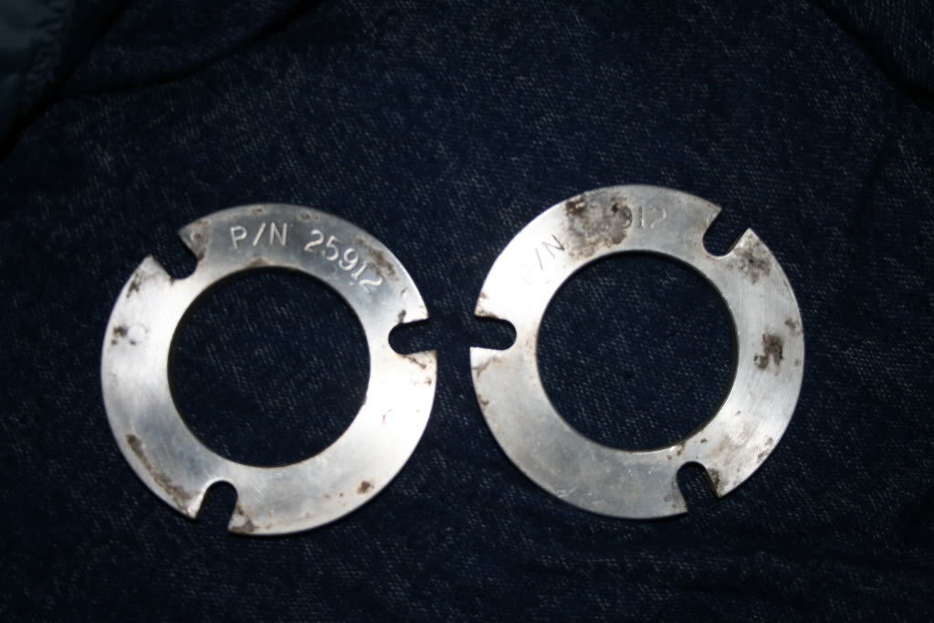

    I have these toytec spacers (P/N 25912) I no longer need. $20 plus shipping if your interested. My zip: 15905 I could send in priority envelope for about $5 anywhere in US. They could use some buffing if you like them to shine. They are 1/2" thick designed to lift 3/4" These will fit a 2002 Tacoma.

    yeah im intrested how do you want to share our sending info, through email?
