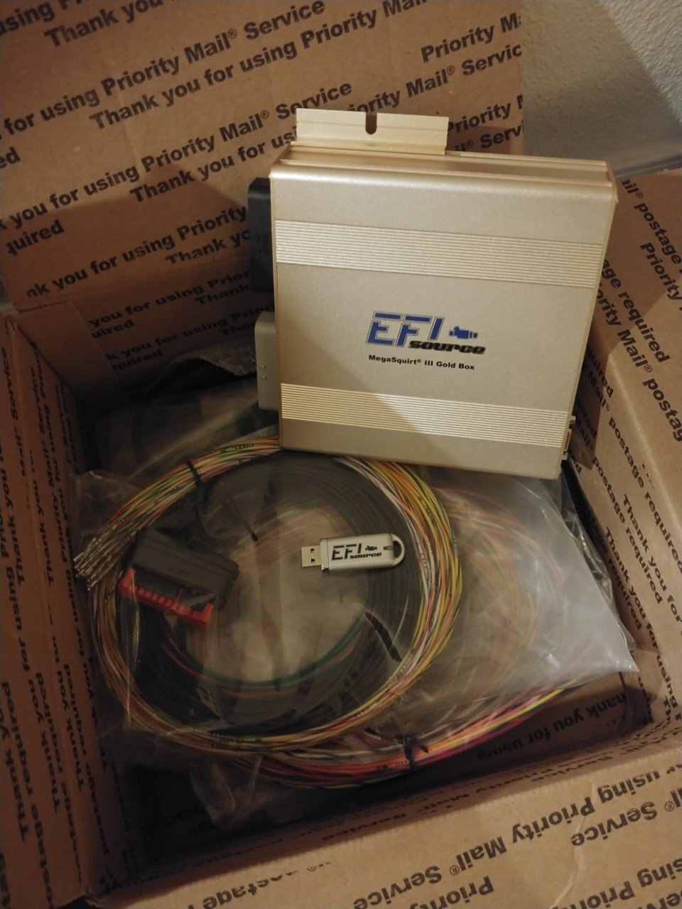

    Shameless plug, but since this thread is getting views... I figure it's a decent time to mention I'm selling a brand new Mega squirt 3 gold box standalone ECU.
    TacoBike likes this.

    is that a substitute to the fic 6 ? I can wire it up to my truck ?
