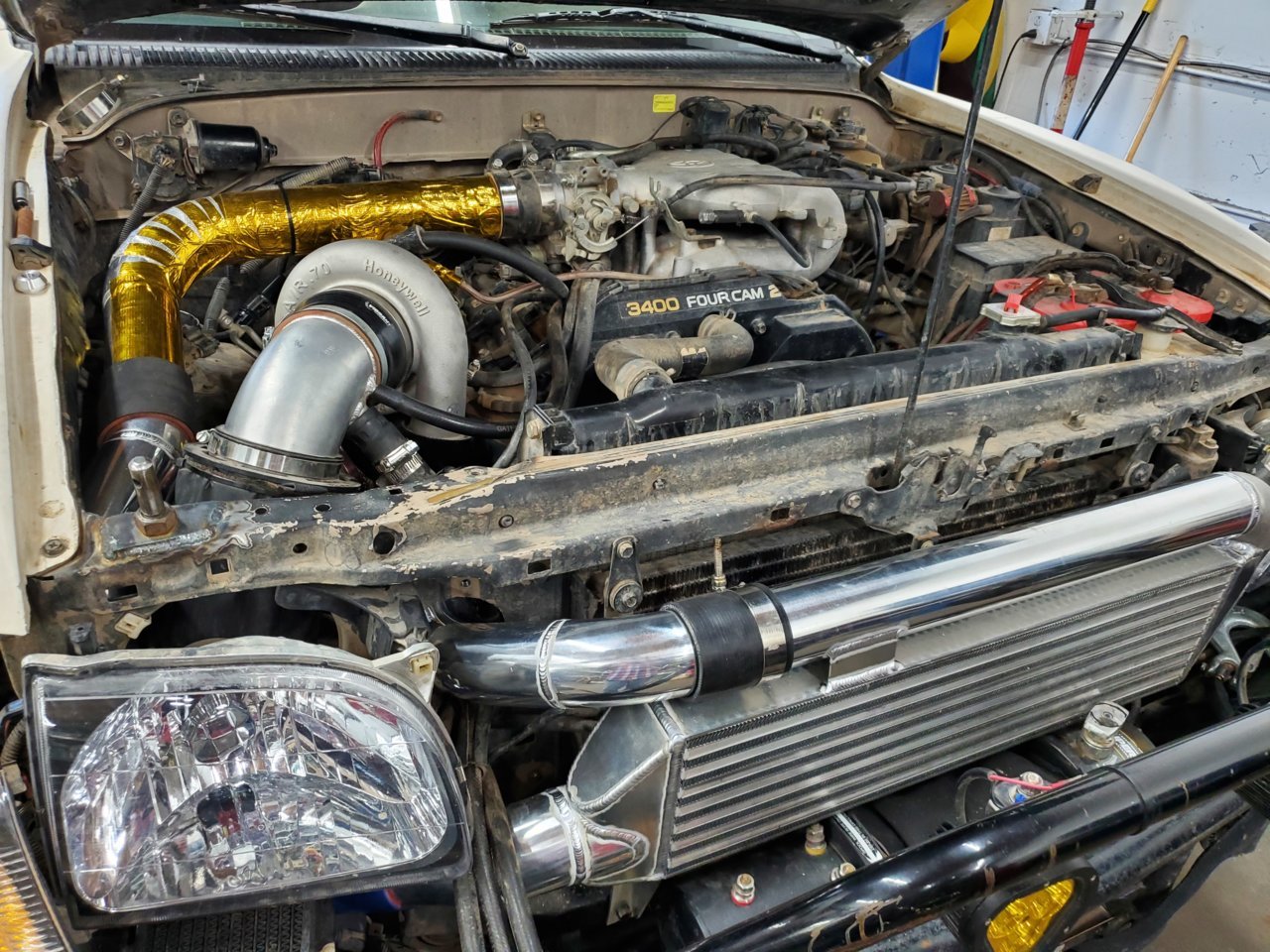

    Fic6 is good. Ran straight Sc, twin charged and now just turbo on it.

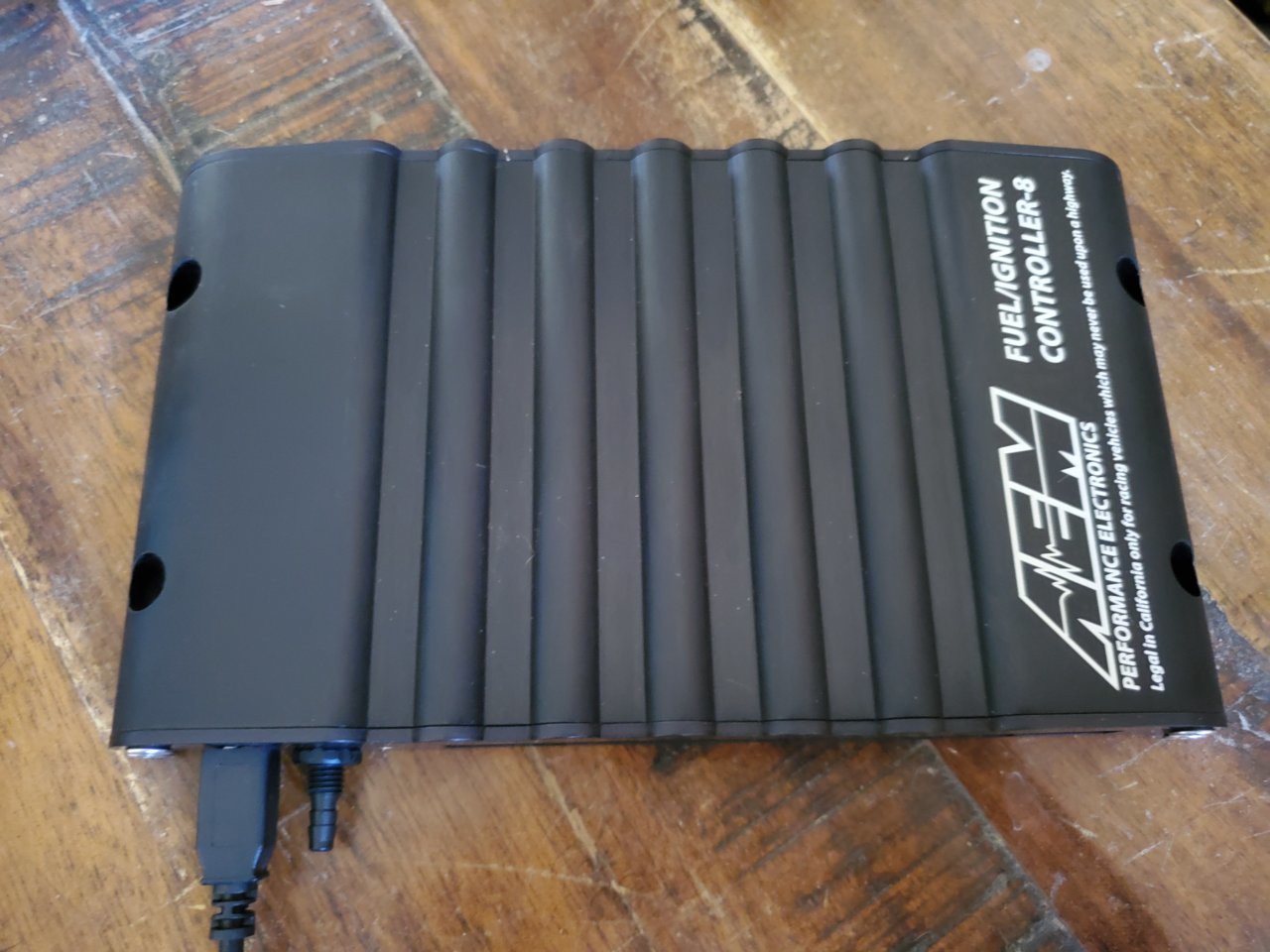

    Just got a Fic 8. Has a boost controller, and more logging capabilities.

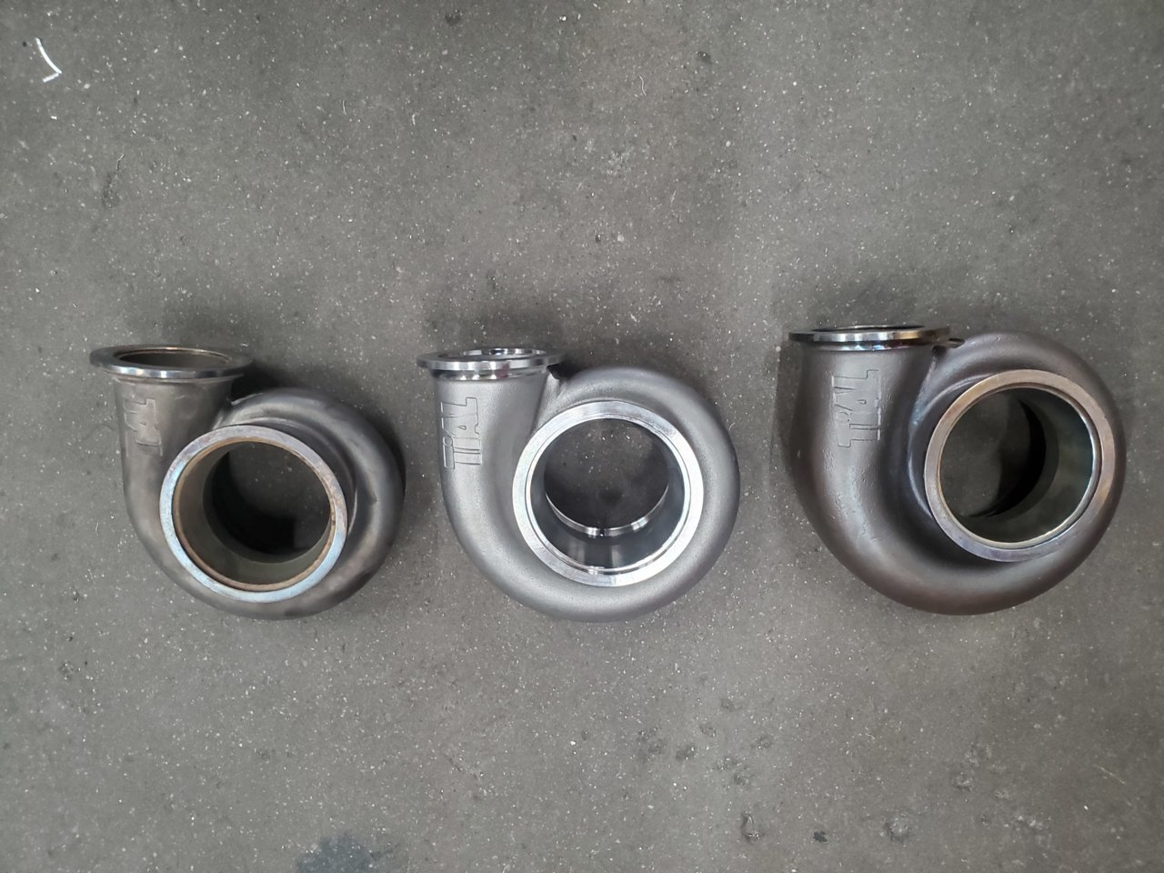

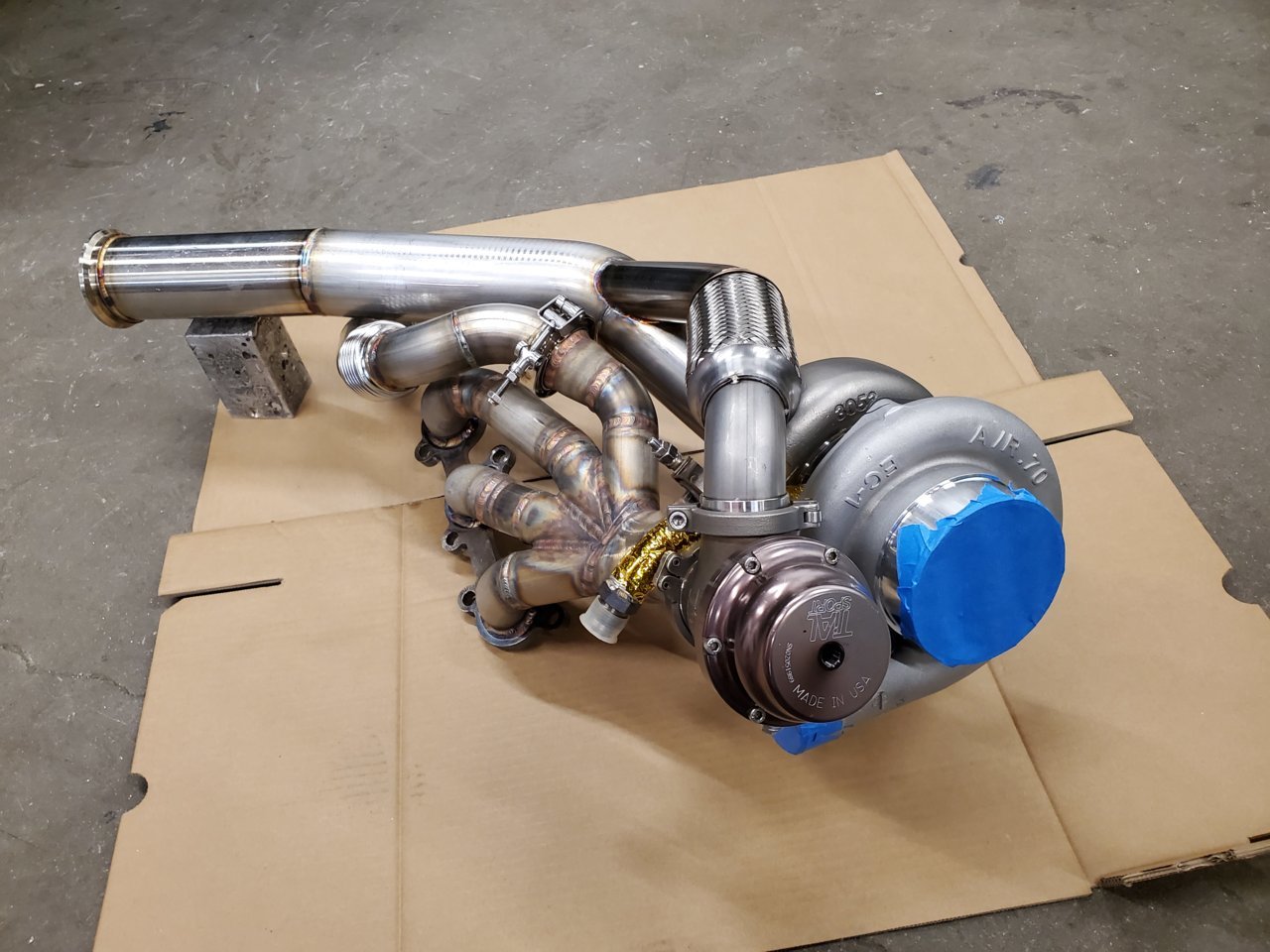

    I would honestly say just go turbo. If 3.4 liter, Gt3582r with .82 housing. Fmic, 3" exhaust and 440cc injectors with Aem 340 pump. Amazing.
    20210316_170625.jpg 20210309_170131.jpg 20210102_170458.jpg 20191125_170532.jpg 20191121_162117.jpg

    Very responsive. 13psi at about 1200 rpm wot. Burn out city. Useless in sand, very embarrassing. Just digs holes in 4x4. Choked out up top, even with SC bypass open.
    It would need a built engine and a gt4294 turbo with e85/high octane to thrive.
    Honestly just pick one or the other. Save the money and headache.
    Sc bolts on so easy.
    Turbo is more intricate, but will make more power overall.
    Be realistic with your wants and needs, especially in this economy.

    You could probably run a larger turbo even. I ran a gt4202r and a built ct15b on my compound 1jz vvti. 40psi total on e85. Very braud power band, but it really needed to go to 50 or 60 to really get into the efficiency range. More than the map sensor and stock engine could handle. Got bored and sold it to get into trucks.
    The SC basically turns the 3.4 into a 5 liter. It was spooling my 35r way too quick even with the largest exhaust housing. Going with a larger turbo would spread the power band out and make it more usable. You would want a turbo that can move alot of air at a low psi to keep the compound psi down. With a built engine you could run more psi, I'm still on a stock engine so 13 was has high as I went.

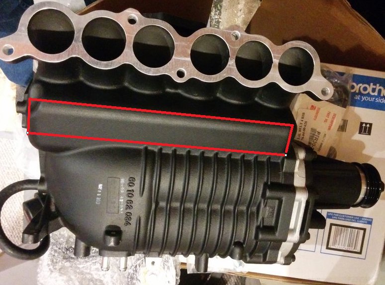

    Highest I’ve heard of someone running consistently is now the 20 psi. Was 18 on customtacos. I was also looking at the bottom of our 2nd gen housings and wondering if we could put a water to air inter cooler in there? Looking from the bottom and sliding one in like an air filter where it is square? Would need a broken housing for a donor for this

    Cutting into the supercharger here:
    And sliding in a water to air intercooler. Though I dont know if the manifold after it would be sufficiently large to even the pressure to the cylinders.
    I imagine it kinda like the 4.0 SC, it would almost look like sliding in an air filter with water hoses attached and bolting it on
    Also: what angle would be best? angled with more volume after the cooler or with the runners to the cylinders immediately after? Or somewhere in between?
