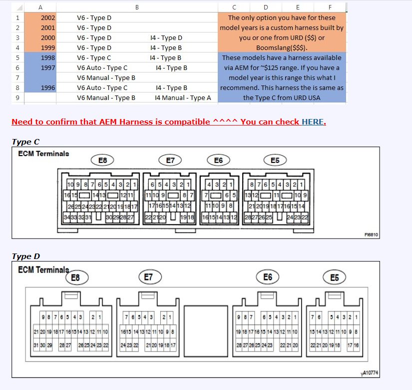

    Anyone know if that urd harness will work?

    Cant remember, those harnesses are lables by 4runner i believe, dont know if they match or not. I think its in the fic tuning and help original post?
    Found it, Yes it should be Type D, just know thay its just a middle extension and you still have to wire all of it instead of just pnp. You will use the harness the fic comes with and self supplied resistors.

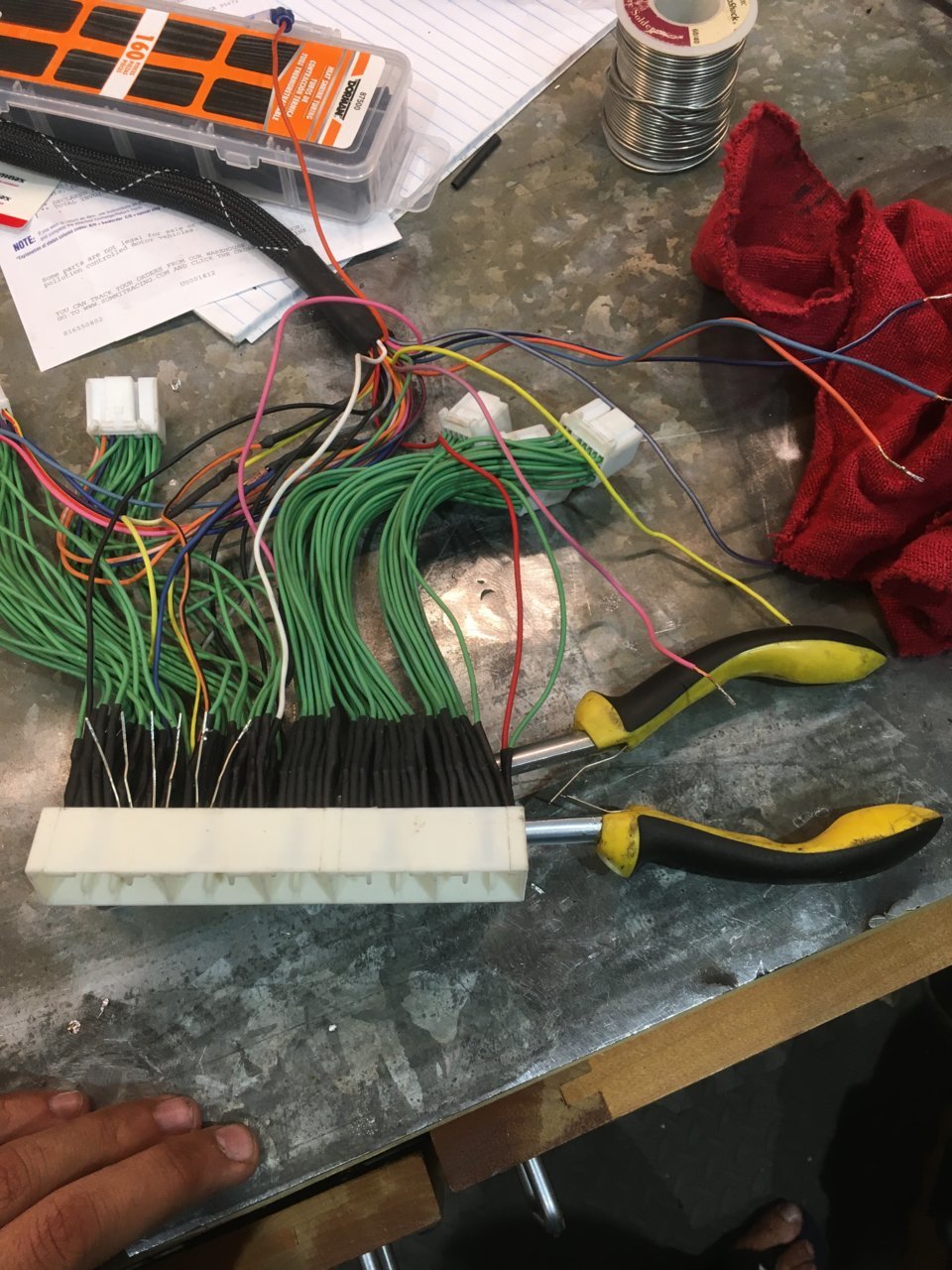

    @TacoBike so I’m wiring it almost like a radio. That harness would go into ecu and fic would get wired to harness ?

    From what I can see, its just an extension so you arent cutting into the oem harness. It should be just tapping and intercepting wires on the harness that you do. When finished it should look something like this:
    (wasnt completely finished int his photo.)
