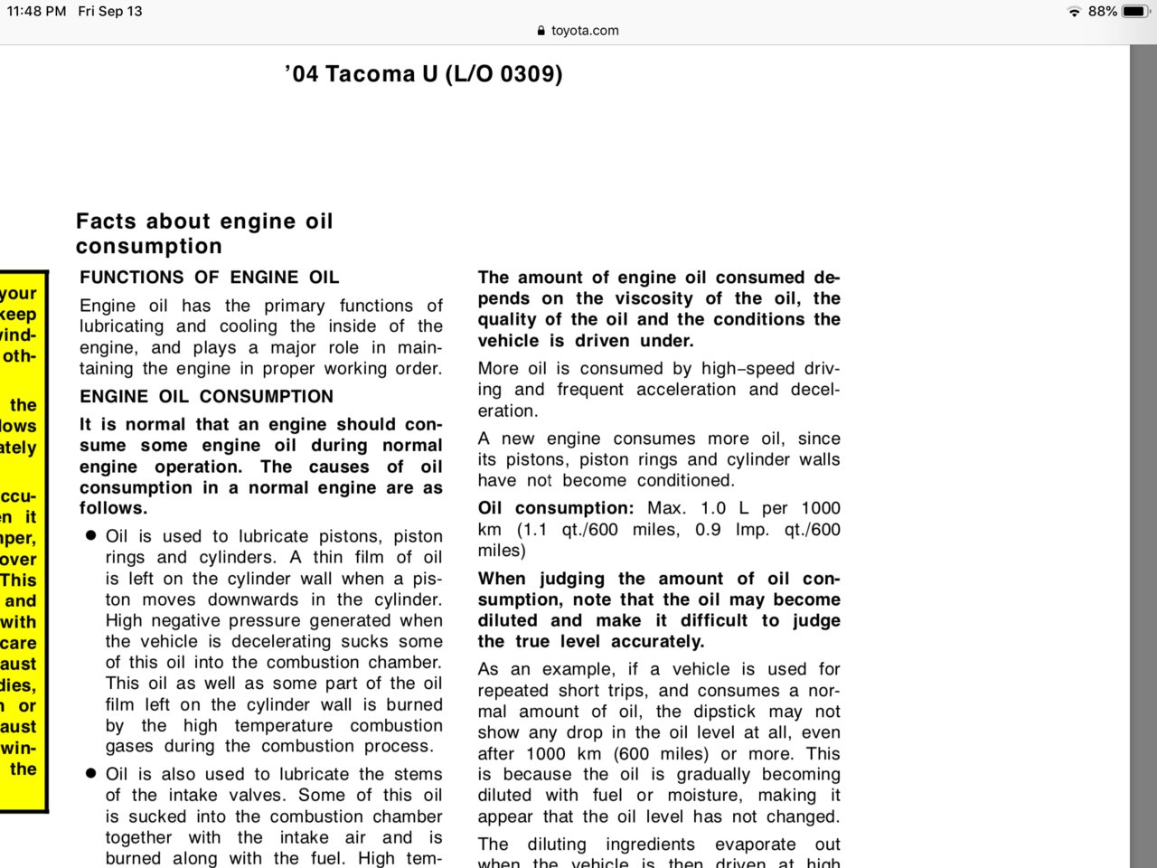

    Ehhhh, I believe the manuals says oil consumption can be a maximum of 1L of oil per 1,000k.
    Or for us here in the U.S. - 1.1qt per 600 miles.
    Ok, ok... In reality your case seems a bit high for most engines in the Tacoma.
    I’d say normal would be may 1/2 quart per 5k?
    Although, I did have family member with over 300k miles on a 2.7 that would use about a quart of oil between changes. This truck was used on a farm and did haul many heavy loads weekly.
    Here is a pic of the 2004 manual on the oil consumption. I didn’t just make it up.
    Here is a link to the manual too. Info is on page 2009.
