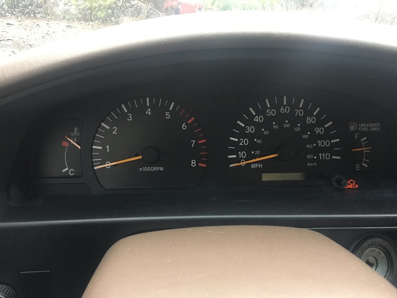

    last night I was driving and hit a high rpm. Shortly after the truck starting stalling and check engine light flashed a few times before the truck shut off and the check engine light stays on. Tempature gauge is pegged the truck never over heated. Truck will not start. With the egnition off the check engine light is on and the temperature gauge is pegged. Coolant is good there is no antifreeze in the oil. Timing belt is good. Tried to hook up obd2 reader and it would not read my truck. Can not figure out what the issue is.

    3.4v6 130,000 miles 5 speed 1998 tacoma it will crank just find doesn't want to start never made any knocking or smoke nothing like that and I hit rev limiter the ground was wet

    No key is not in the truck and hasn't been started for more than 12 could it be a short if the gauge is pegged like that and engine light is on

    Unplug the alternator and check all your grounds.
