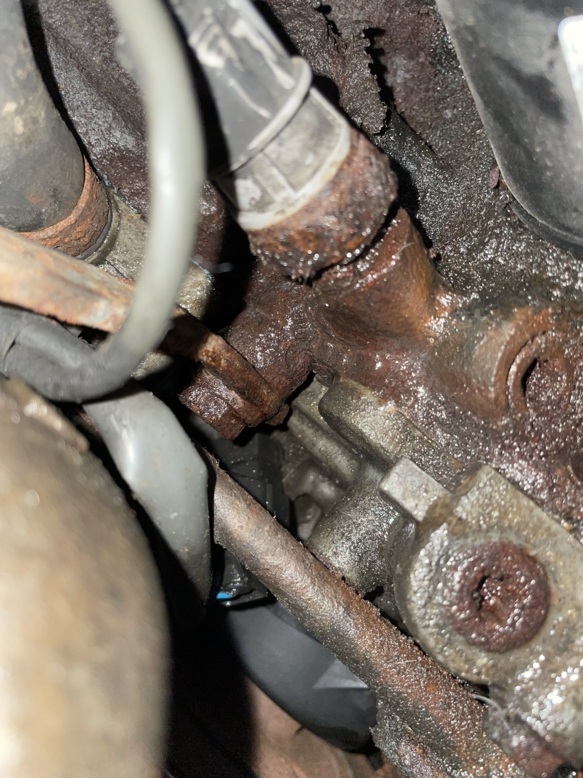

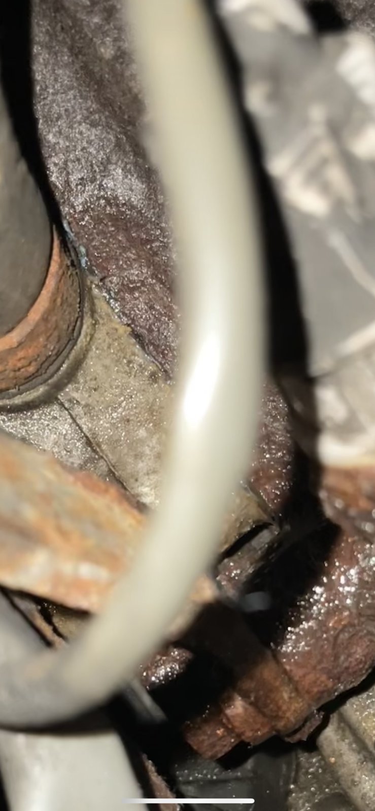

    I picked up this 03 3.4 a while ago with 250k on the odo and recently developed a coolant leak from the front of the motor. You can’t see where it’s coming from with it all assembled it appears to be coming from behind the thermostat i have no knowledge of when the water pump was last replaced but judging by the threads on the studs they’re pretty rusty(i’m in the rust belt)it’s been a while. I was curious if this picture is enough evidence to replace the water pump and gasket along with the timing belt or if i should rent a pressure tester for the cooling system. Its really hard to see where the leak is coming from due to lack of space with everything assembled. Any advice is greatly appreciated!

    My 04 just started doing the same thing. At about 250k. It's past time for a timing belt for me so I'm having the belt, water pump and thermostat done. Can't help you with where it's coming from but I figure it's either pump or thermostat and time to get them done anyway.

    I figured it was about time for those anyway just haven’t ordered the kit yet and need to do some research on where i can find an oem kit. thank you!

    I want to start off with thanking everyone that gave me advice! I am grateful for you all. She got put back together on wednesday of last week, then I go to start her up and see I’m pissing coolant from that little bypass hose so I pulled the old clamp and replaced that, it has been dry since. After that I ran it, I changed the oil since I feared I’ve contaminated the oil when the dipstick tube was out and I doused the block in coolant. I’ve put 90 miles on the new wp and tb so far and I’ve just tightened the radiator hose clamps and purchased a new one to replace the old constant tension clamp since it is visibly seeping coolant. Thank you all!
