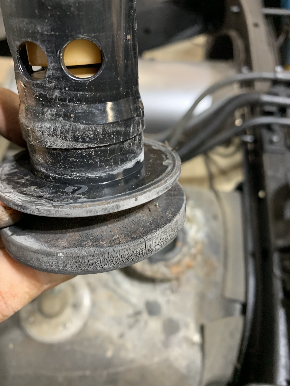

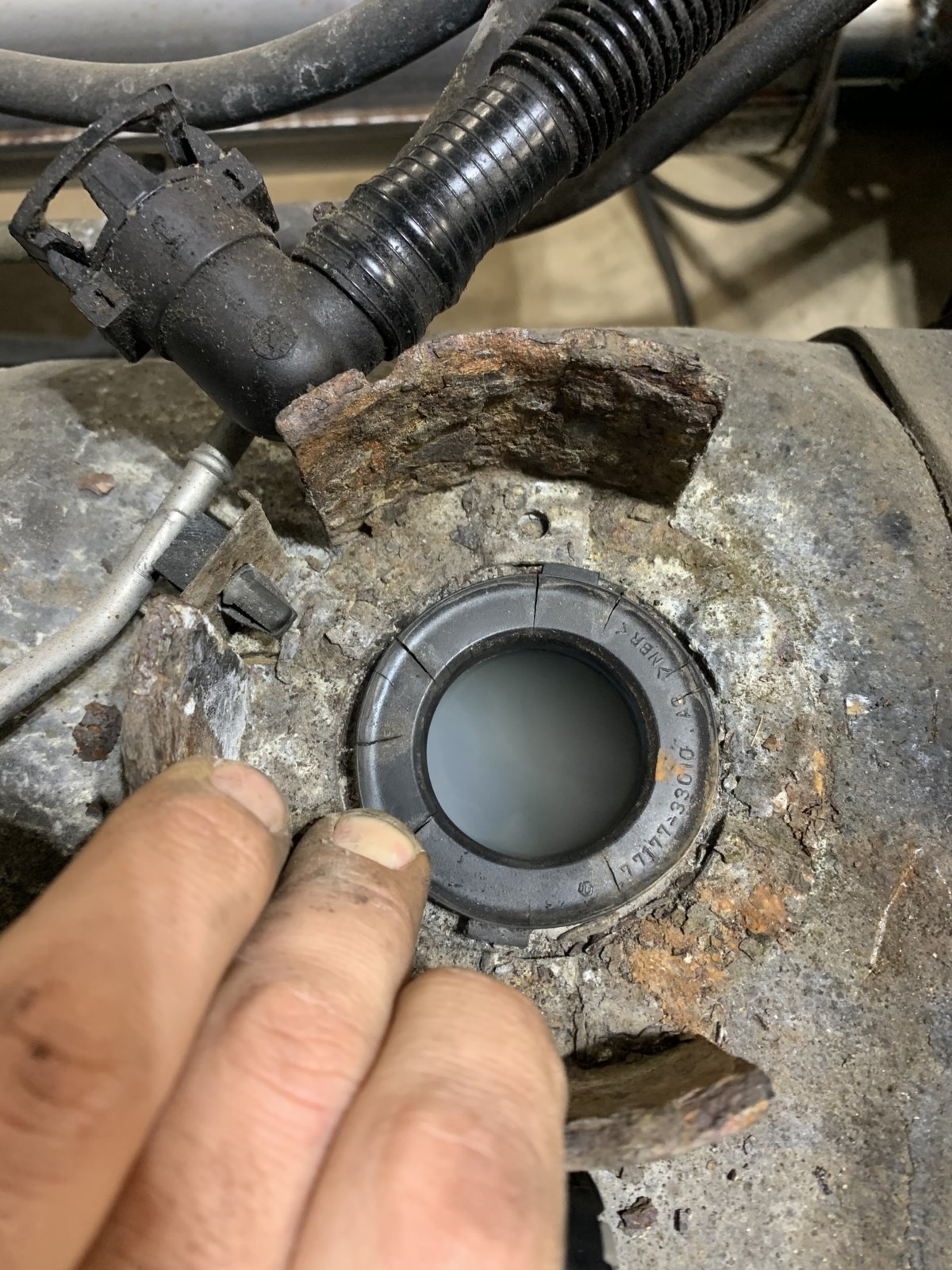

    Another parallel issue I’ve had with this truck I’ve owned it has been two codes and a CEL: P0442 & P0446.
    Today after pulling the bed in preparation for a new fuel pump I found the small nipple going to my fuel vent check valve broken. Not sure if this just broke or broke when I installed my bed last. I plugged the opening and did a smoke test on the tank. The vent check valve was still leaking slightly so I pulled out of the tank and saw the seal was very cracked and the housing had a few hairline cracks. So new one of those on the way!

    New fuel pump solved my warm start issues!!!
    New tank vent valve solved my CEL evap codes!!!
