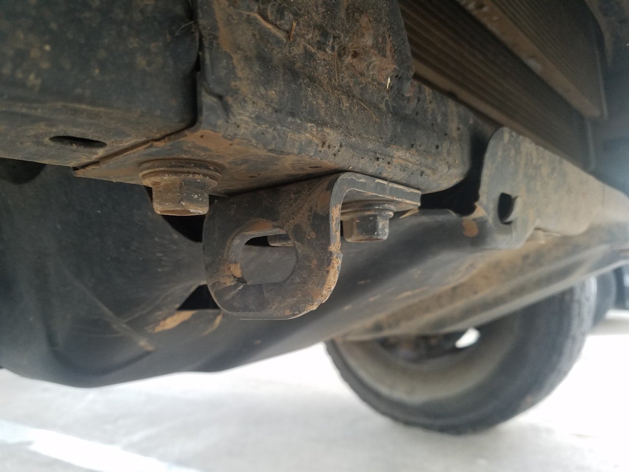

    I do to......take a pic of where you are wanting to attach it, lets see what you are working with. I dont know of a recovery rated point on the front of a prerunner, but I may be mistaken. there is likely a securement loop, but it is not rated to recovery

    Ahhh, that. yeah, that is the factory thing. I wouldnt trust that in a recovery situation......more for tyeing the truck down on a flatbed.......

    The tie down loop is the other thing. The item pictured is actually the recovery point. It's not ideal. The SOS recovery point is a good option. I replaced mine with a TRD OR recovery hook. Every TRD OR Tacoma with an aftermarket bumper used to have the hook. The hook is nice, 'cause you don't need a shackle to use a snatch strap.

    10-4 to that, good point. I remember the hook :thumbsup: hooking a strap to a shackle is best, to prevent strap from coming off under slack
