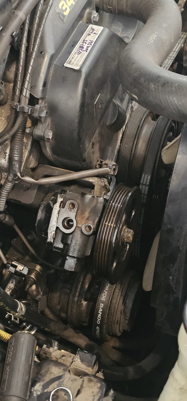

    Issue: I have no power steering at low RPMs, but power steering function kicks in above 1500ish rpms.

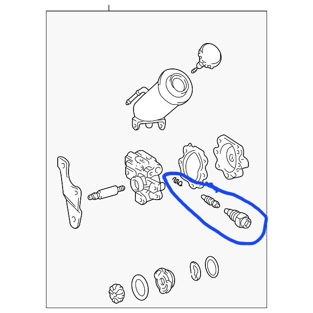

    I'm looking for the parts to replace the pressure release valve within the PS pump but haven't had any luck finding the parts online. Anyone know where to find OEM replacement parts for this item?
    Help finding OEM replacement parts for this valve is my main question, below is more info on diagnosing the power steering issue,, and some sweet pics..

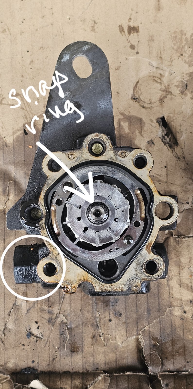

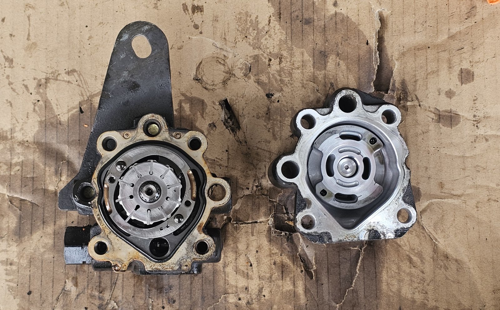

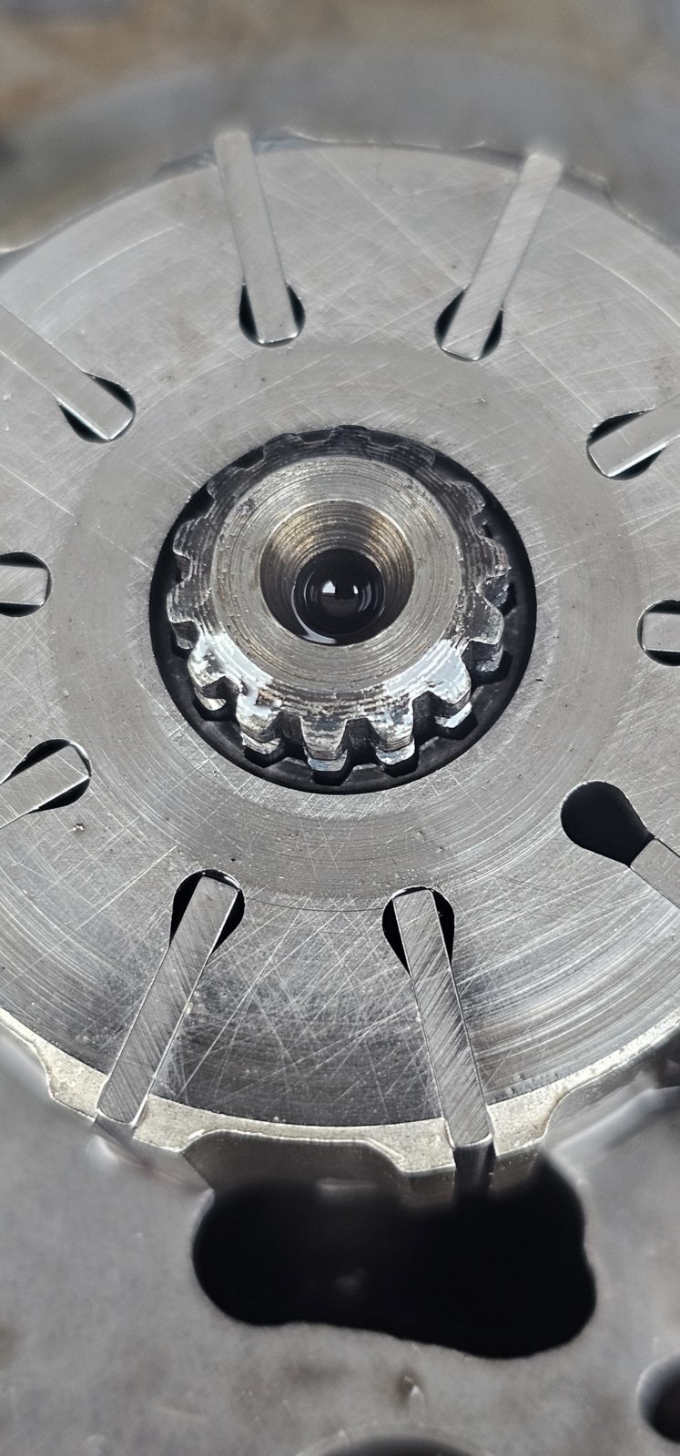

    -Then, I took the pump out of the truck and rebuilt it with a Toyota OEM seal kit
    -Upon inspecting the insides of the pump I did not see anything worn or abnormal, it seemed fine, I replaced the old seals while having the pump apart..
    **I however did not disassemble the pressure relief valve to check its condition which I believe is accessed via the bolt that is circled in the pic below.

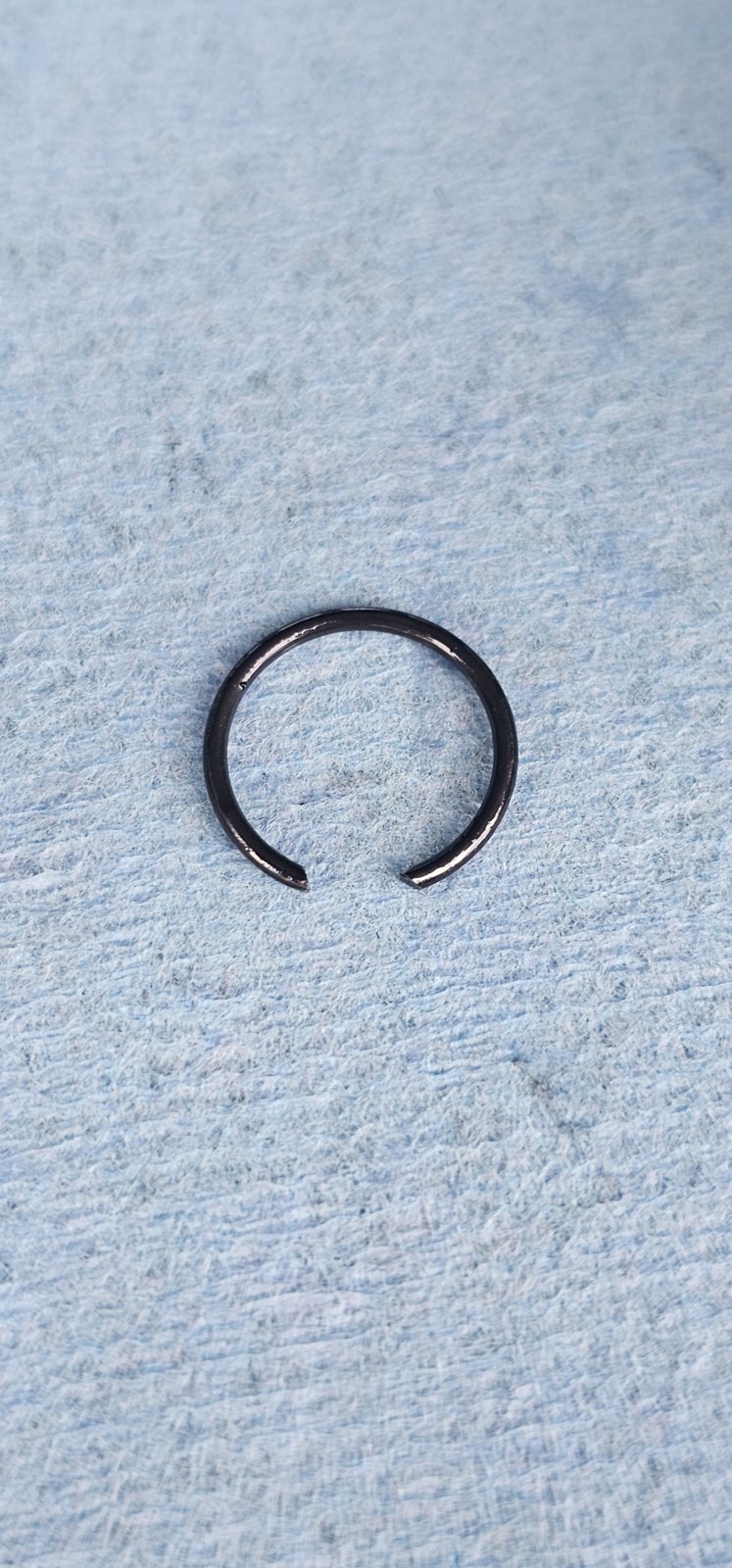

    While taking the pump apart the one the one thing kept the pump spindle locked inside the housing was a small snap ring. I thought it was funny to find that this little ring kept this thing that rotates so aggressively in place. The more I venture down this DIY mechanic road (which has been quite a bit of fun) the more I'm amazed at what stands in the way of catastrophic failure.
