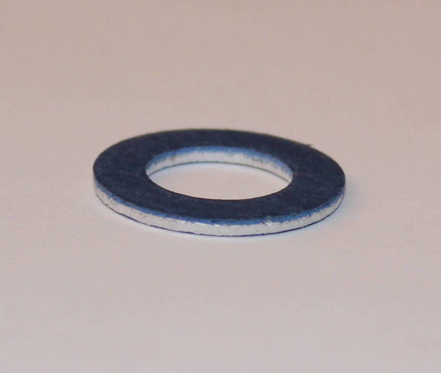

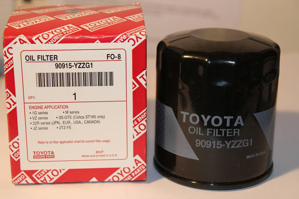

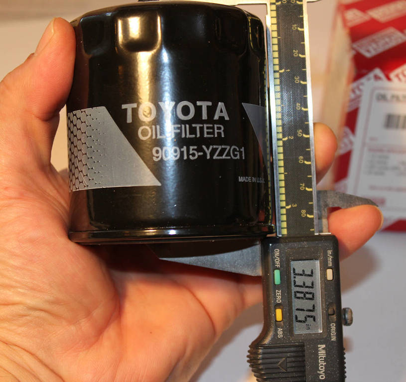

    Hey folks,
    I seen a lot of questions regarding the oil filter and oil plug gasket. I thought I'd post some pictures and specs.
    For the 5VZFE, the filter I got at Toyota was #90915-YZZG1, made in USA. I paid $5.41 plus tax and they thru the gasket in for free.
    It measures about 3 3/8" tall
    The oil plug gasket is a steel washer sandwiched between blue two fiber washers. It measures 21mm OD (.827") x 12.25mm ID (.4825") x 1.70mm thick (.067")
