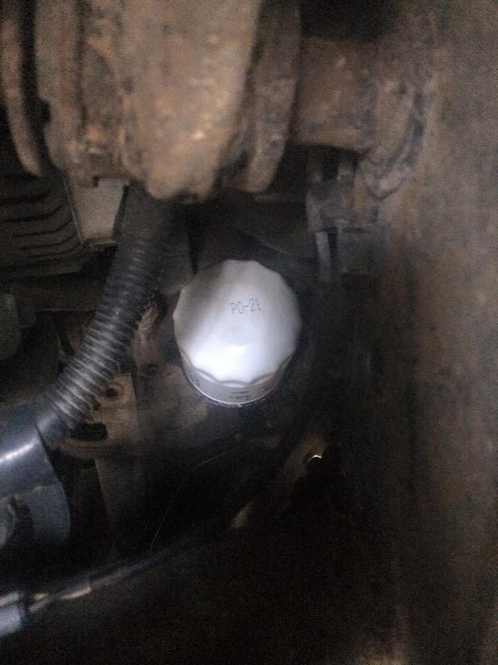

    Mschop
    Mschop Well-Known Member
    Sep 18, 2015
    #164616
    79
    San Francisco, CA
    2004 Tacoma 4x4 4-Cyl
    Is the filter in a different place for the 2.7L? I couldn't find a walkthrough for the 2.7 so I followed this guide - everything was the same except the filter was on the passenger side. I attached a picture for reference.
    2002Tacoma4x4 likes this.
  10. Oct 10, 2015 at 10:03 PM
    #70
    00yotasr5
    00yotasr5 Well-Known Member
    Feb 6, 2011
    #50676
    970
    lee
    merced, ca
    00 SR5 4X4 RED DEVIL
    Icon ext travel expo leafs rear billies 5125 10'' travel bamf bpv relocate Brute Force Fab Sliders allpro ss brake lines f/r LR UCA 22in wetokled bar RAT Products ifs skid ARB rear locker Ultra gauge Redline Hood Struts Blue Sea Fuse box smittybilt xrc 9.5 w/TJM synthetic rope trail-gear rock assault low profile bumper LED bed strip 12v/usb charger in truck bed
    you 4 banger got it easy. only thing is cleaning the oil off the rack unless you have something to cover it while it drains.
  11. Oct 11, 2015 at 3:25 AM
    #71
    2004TacomaSR5
    2004TacomaSR5 Nemesis Prime
    Apr 28, 2011
    #55722
    5,081
    Jon
    Montana
    2004 Tacoma DCSB & 1980 Toyota Pickup 4WD
    Tacoma is stock and staying that way, Pickup is TBA as of now.
    Yep, it's in a much easier place to get to that's for sure!
