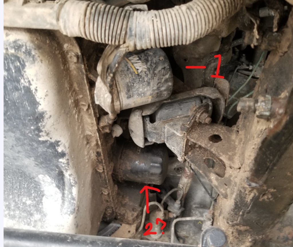

    Ive had multiple tacomas with the 3.4 engine and done countless oil changes plus other maintenance. Has anyone ever seen 2 oil filters before? Ive never seen this on a 3.4 Tacoma before, thoughts?

    sumbody put an oil filter where it looks the oil cooler is supposed to be located ??

    So #1 is the terrible designed OEM factory oil filter
    No clue on #2

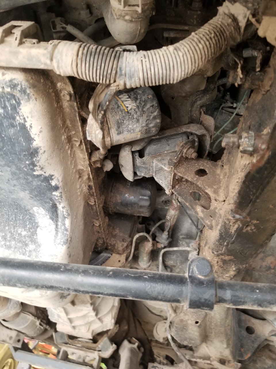

    what it looks like from here
