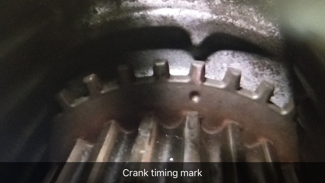

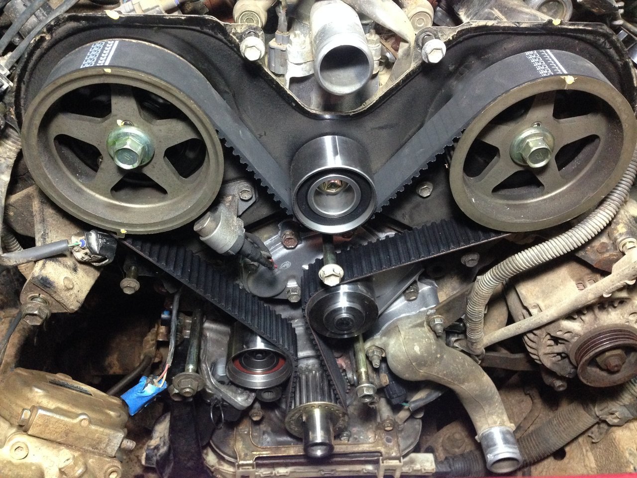

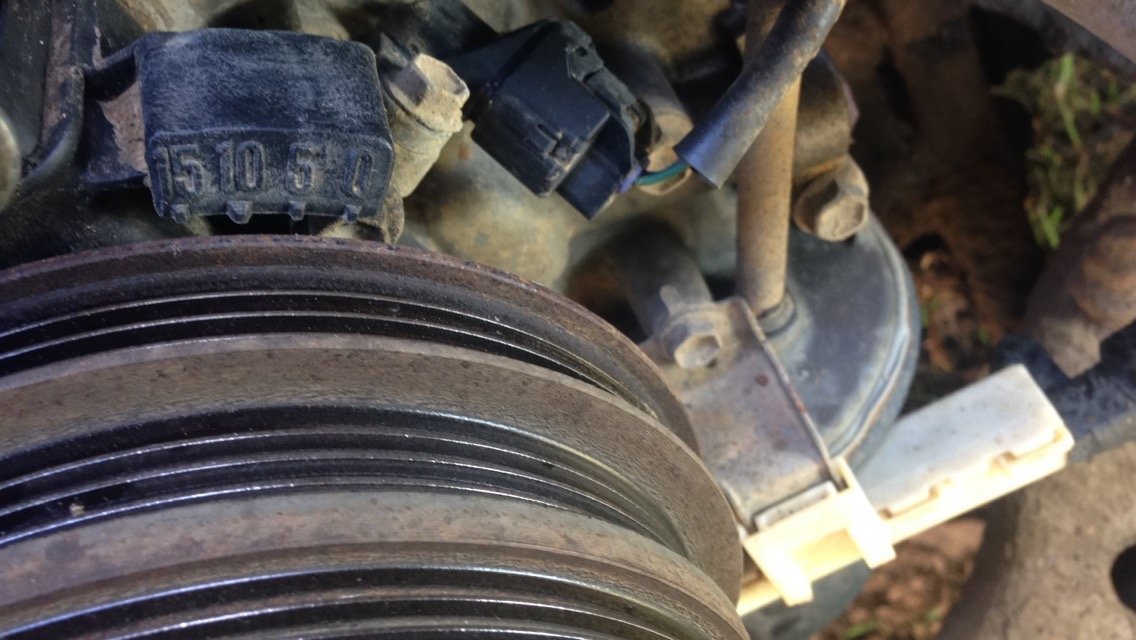

    I think you'd have a miss if the cam or crank sensors were bad, and you're only having trouble at 2,000 rpms & higher. The tone ring was a good idea to check. If the woodruff key sheers, you'll know it way before 2k rpms. When setting the timing- are you lining up the crank mark & the cam shafts? Use dielectric grease on all your connections too.

    Yes everything is lined up perfectly and I put dielectric grease on every conextor when I did my Moter swap last month.
