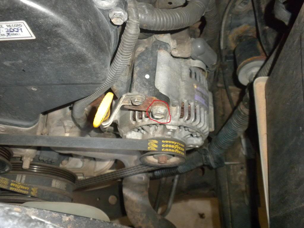

    Anyone run two alternators? Or fabricated up a dual bracket?

    Where would you put a 2nd one? No room with the 3.4L.
    Why not just do a higher amp output GM alt. It is practically bolt on.

    Where would you put the 2nd alt?

    Design a bracket that will allow to bolt up with said red circled bolt and run second alternator in space above the oem location

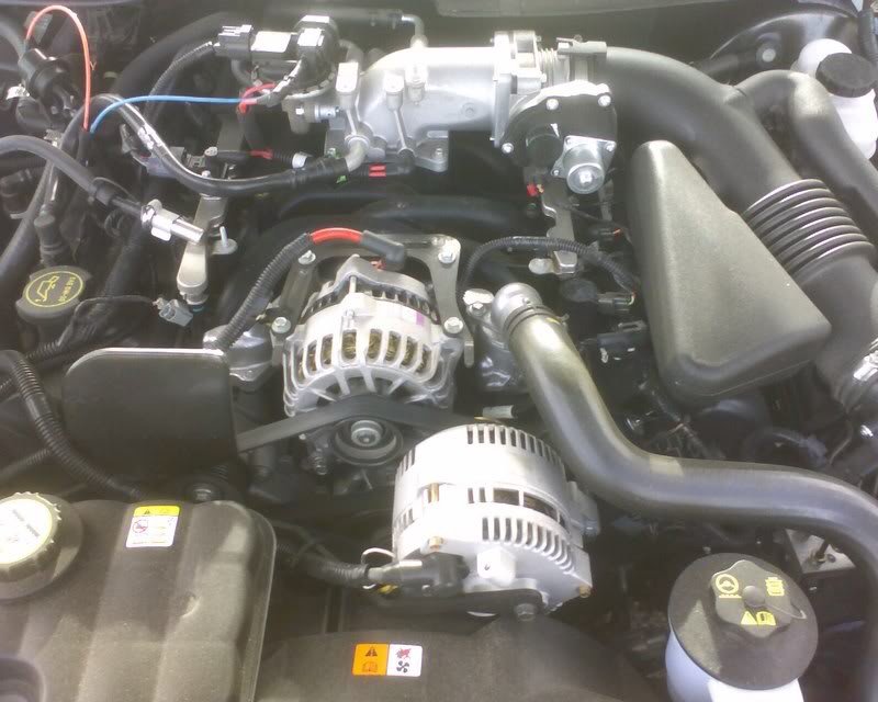

    This guy got creative 9b2f49a3960aa7eefa3713a2befe4449_924f5f204b22a0a96903c84e35e0255dba519b9a.jpg
