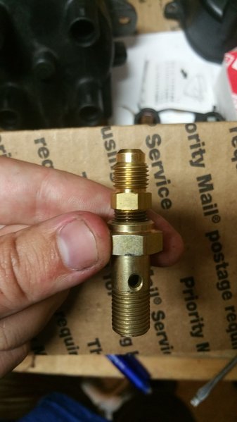

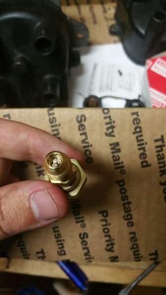

    To test fuel pressure is kind a pain but do-able and I can save you some trouble I went through. I originally bought the Actron fuel pressure kit that came with a special banjo bolt with a fuel pressure schraeder valve on top for testing pressure. The kit and gauge are great, but the bolt is made of cheap aluminum and broke the second I applied the slightest torque to it. huge pain in the ass, had to dethread the rest of the bolt from the fuel rail inlet with a screwdriver. sucked!
    Solution is to buy the Russell 640700 and a 1/8th NPT fuel pressure test port. thread the test port into the banjo bolt with some sealant and it works like a charm. Replace the banjo bolt on the rail and boom, you have high quality test port ready to use.
    https://www.amazon.com/Actron-CP783...75027978&sr=8-1&keywords=actron+fuel+pressure
    https://www.amazon.com/gp/product/B000CPJI8I/ref=oh_aui_detailpage_o00_s00?ie=UTF8&psc=1
    http://www.ebay.com/itm/252532898913?_trksid=p2057872.m2749.l2649&ssPageName=STRK:MEBIDX:IT
    Cheap actron banjo bolt (sheared)
    Russel bolt with test port

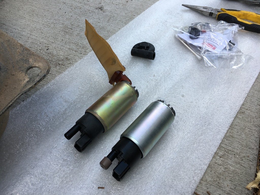

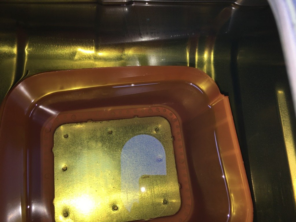

    Wow, I don't know about on a Tacoma, but replacing the fuel pump kinda really sucked today on my 4runner.
    The tank vent hose was impossible to get off, so I had to cut. Even with the damn tank on the ground, I couldn't get that vent off - it was completely fused on to the hard lines. Replaced it though... word to the wise, drive below 1/4 of a tank and park on a flat surface. My driveway is sloped just enough that the doors close on their own (annoying AF) but I also had to craftily use a jack on this slope.
    My tank was clean and it seemed to idle better - waiting for my headlights to cool down from re-doing projector retrofit so that I can install and give it a good drive. I won't know for sure though that everything is a-ok til a week at least - since that's how long just replacing the fuel filter helped the first time around.

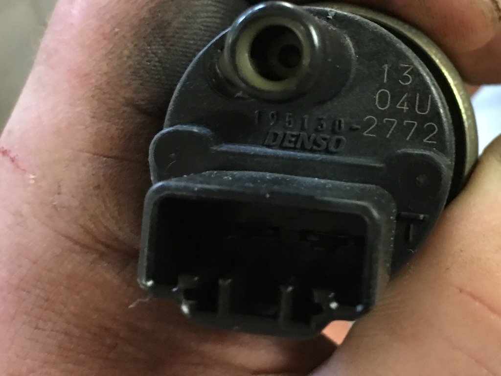

    I'm baffled though - this is the second time I've found Denso products in my vehicle with a number I can't find anything official on.
    The fuel pump I removed was 'Denso 195130-2772'. The only google results are foreign sites listing this part number as the fuel pump for a ~2002 Toyota HiAce. The MAF I replaced the other week trying to fix my problems was also a Denso, and a part number that only foreign sites listed - for a whole slew of Toyotas, none of which being a 3.4L.
    Where the F did these parts come from, you'd think I'd find at least one hit for these part numbers on a message board like this if it was ever used from the factory in vehicles distributed to North America. The original owner had it serviced at a dealership exclusively, so I don't think they would have.. and the last (second/third - brothers) owners did DIY some stuff, possibly the fuel pump, but didn't speak english well enough to say clearly. I doubt he drove to Mexico and got some mystery parts down there, but I guess it's possible.

    and the mystery fuel pump...
    ED5FFB36-9C37-4DF7-BC7D-21E3082F5679_zps_fe8741e18d6536c53fb475df5bde966013a0b931.jpg

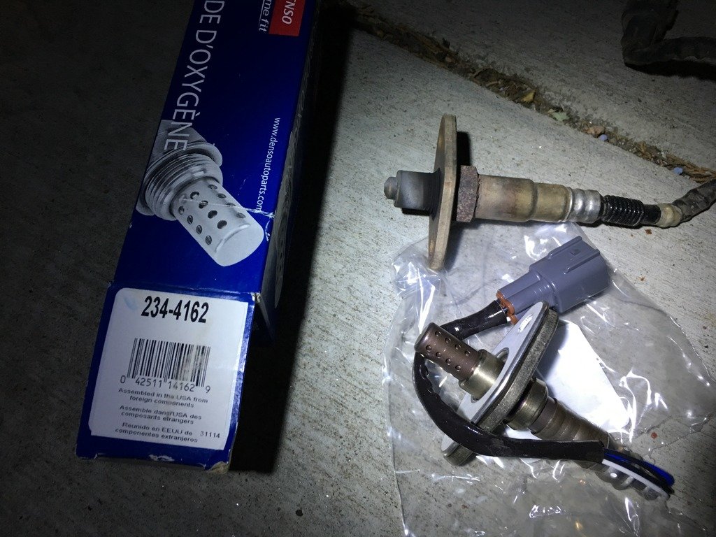

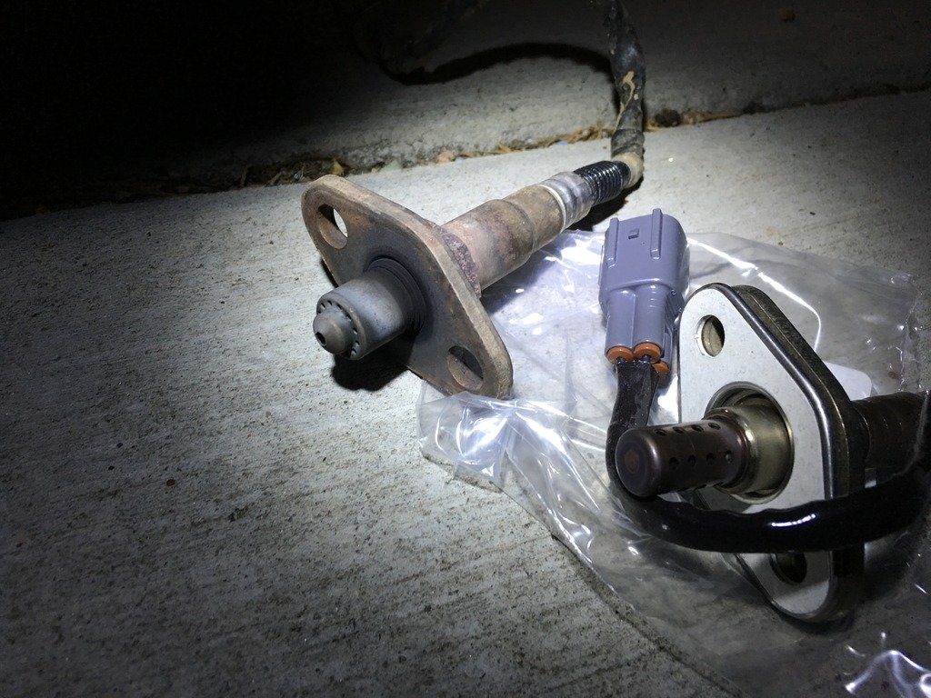

    I ended up taking it to a Toyota specialist shop this morning. Guy said he thought my cat was going bad based on some voltage deal with the sensors. That caused him to look underneath the car and comment on how my cat was aftermarket, and seemed way smaller than normal. Didn't charge me for looking at it, talking to me for like 30 minutes, nor riding around together taking turns driving it
    That lead me to think that the cat was clogged.
    That lead me to spend a few minutes with the dremel to cut the stuck bolt holding my upstream o2 sensor on and create a pre-cat exhaust leak by loosely holding the sensor in by the one good bolt.
    It felt better snappier but still not right.
    Hours later I look through previous owners receipts. Had a CEL one day per a brake shop receipt in the comments box, got a cat two days later from an exhaust shop, failed emissions four times while replacing other things per Napa and OReilly receipts, changed the o2 sensor and the receipts ended... and he passed emissions
    I could tell that the sensor he bought was installed downstream of the cat because it looked newer, is more responsible for emissions failing, and with the condition of the front sensor bolts. So I went out in the dark and popped the new sensor in pre-cat and reset the ECU. (TLDR)Drives better than it ever has. Perhaps this was a case of a silently failing o2 sensor, and somehow dry cranking my engine after changing the fuel filters made it queef out some dust and work less sporadically, just for a little while. IDFK, but I've finally gotten somewhere. Still replacing cat and downstream Bosch sensor PO put on with a Denso.
    What came off
    Unknown age but detective work of last owner and one before him indicate no less than 75k on it - likely way more.
    Part #21109601
    Internet reveals Denso o2 sensor for a 06-07 Passat.
    Very little mention of this part # across the web, just like the MAF and fuel pump part numbers.
