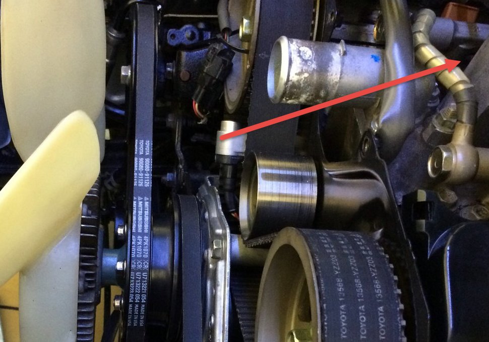

    About two years ago, I had to replace the oem radiator. So, while I was at it, I replaced the hoses, thermostat and the coolant sensor for the ecu that's located behind the top radiator hose housing.
    Toyota Part #89422-35010.
    I had a '97 Camry that had starting issues due to the coolant sensor, so while I had mine apart I replaced it. Unfortunately it made no difference. Still glad I replaced it since the plastic on the original one broke off when removing due to age/heat cycles.
    GQ7227, paulwal[OP] and eon_blue like this.

    Hmm coolant temp sensor you say? That is probably a good thing to check out. My 3.4 for idk the past 7 years of ownership has always had a little shake in the idle. Still runs perfect though. I only thought V Dubs had issues with the coolant temp sensor :) But - good thing to replace while you are in there.
