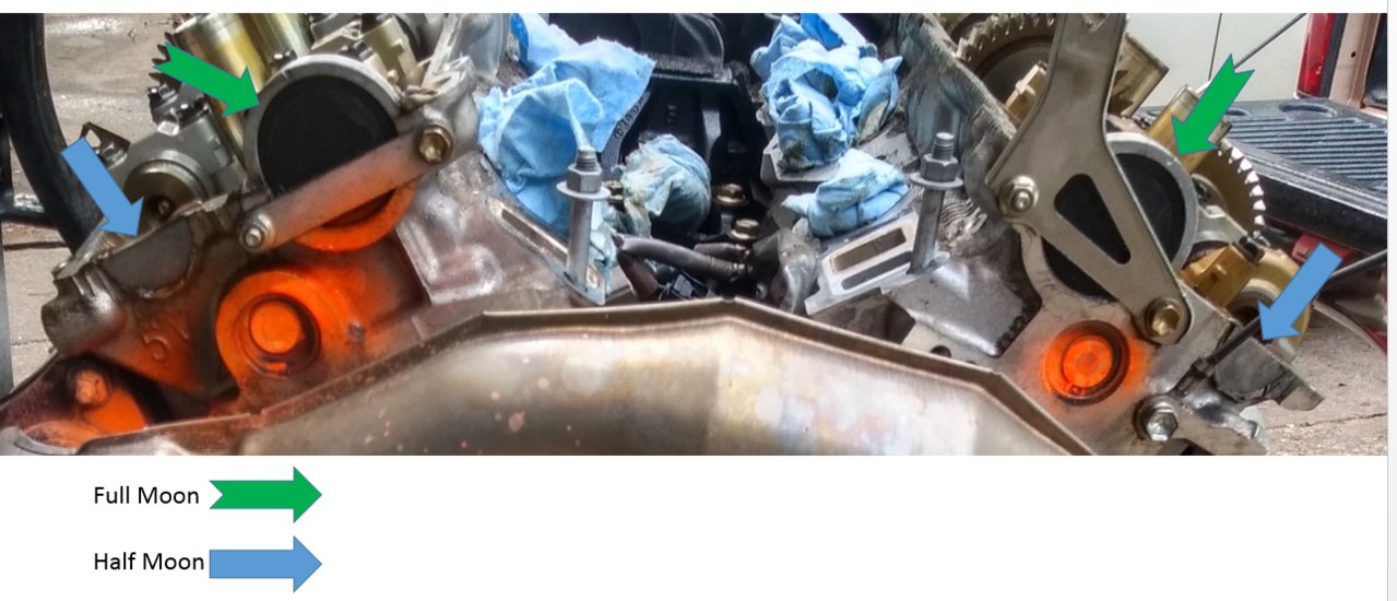

    I got under the truck today and did a little more looking, I think it's definitely leaking from the back of the valve covers and from the rear cam plugs. I'm not sure it's solely that but I'll look into getting VC gasket done in the near future.

    Here's a picture of the engine back side.
    Though I had a shop leave the full moon retaining bracket off and the full moon popped out.
    I would get a mechanics mirror and check out the back side of the valve cover area.
