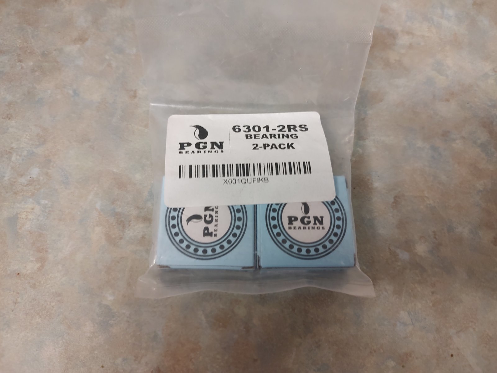

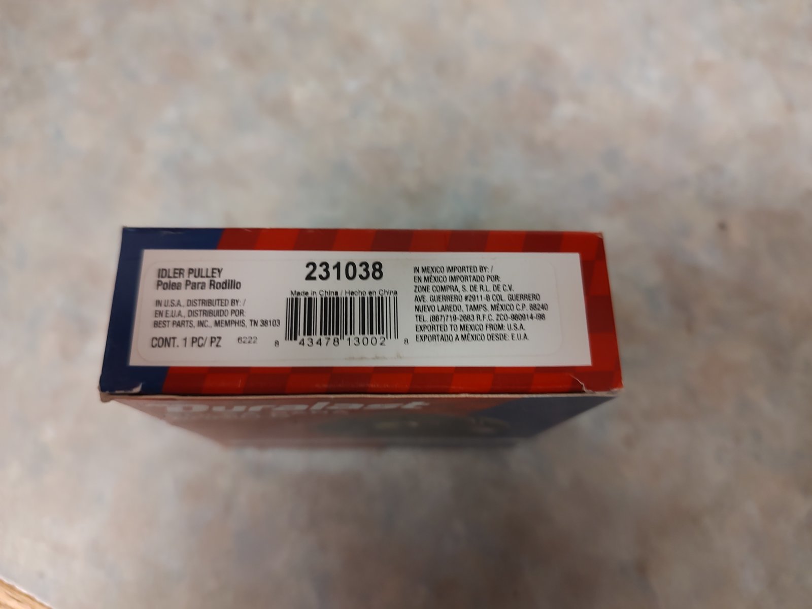

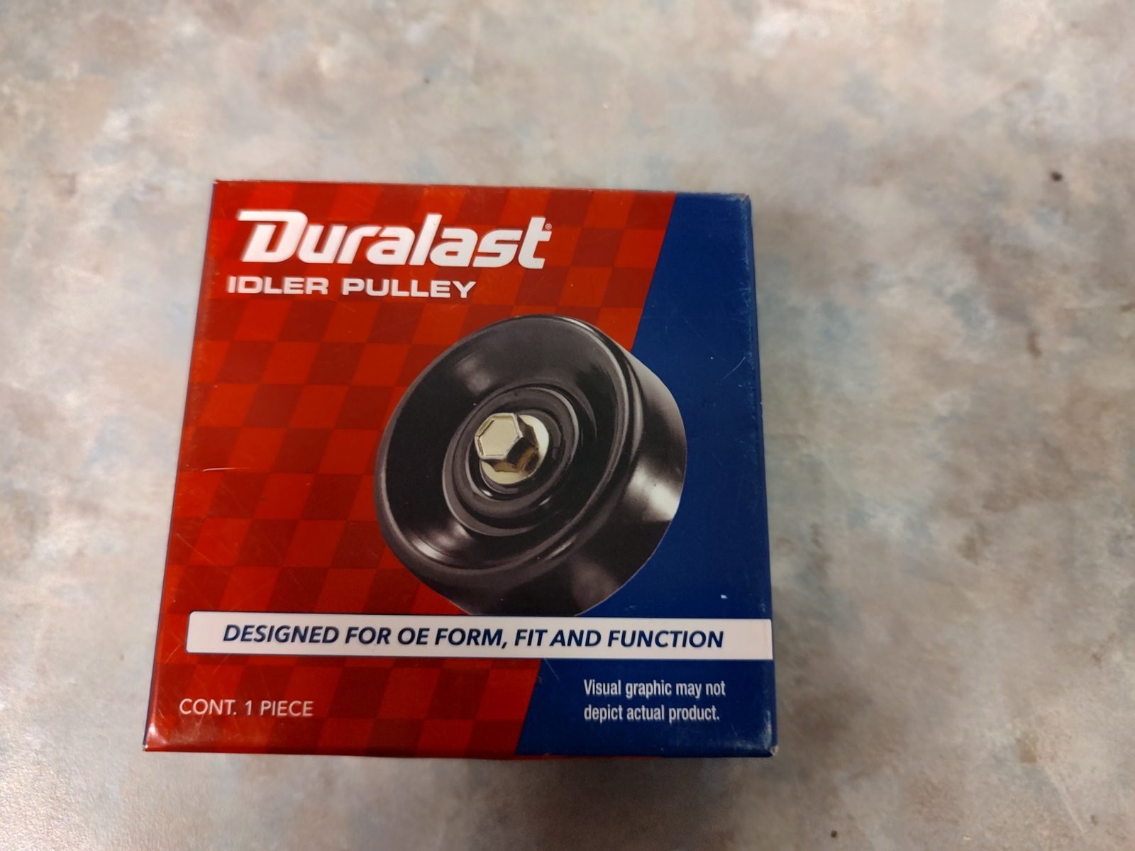

    I'd suggest ruling out the idler pulley first, because it's so quick and easy (and cheap) if it turns out to be the culprit. You can press in a replacement 6301-2RS bearing into the OEM idler pulley housing (easy peasy, and costs about $3).
    6301-2RS Bearing
    Or AutoZone carries a Duralast one that is actually decent. Usually opposed to using parts store-branded parts on my truck, but I didn't have the patience to wait for the 6301-2RS bearings to come in from Amazon, or pay like $150 for an OEM replacement. So I've been running the Duralast one about 7 months, no problems. I've still got my OEM one with the new PGN bearing installed, and that'll go back on when the Duralast one fails.
    Duralast 231038
