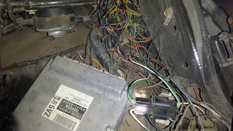

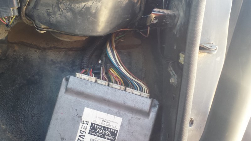

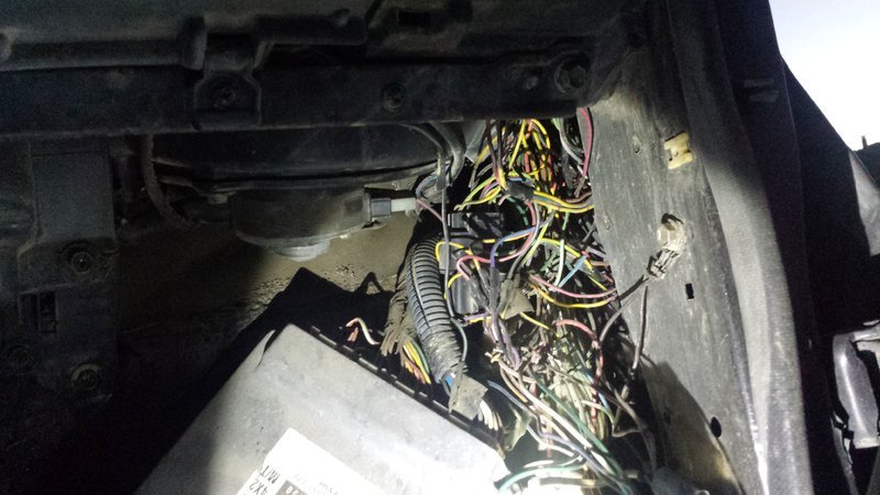

    Yotatech allowed my do this..

  18. Jan 19, 2017 at 10:21 AM
    #18
    Blackdawg
    Blackdawg Dr. Frankenstein
    Dec 31, 2010
    #48500
    81,581
    Monte
    Wyoming/St. Louis
    The Trifecta of Taco's
    Wow.
    haha
    I could never do that. Drive me mad. Nice clean up job!
