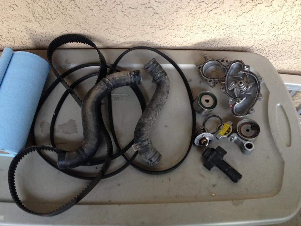

    I kno a lot of guys want to do this project by themselves to avoid a costly trip to the dealer. I successfully finished this job last week and just got around to posting about it... It was a very interesting project to say the least. Here are a couple lessons I learned/ suggestions for anyone who wants to do this job on your 3.4L.
    1. Make sure you have the right tools! U need a good breaker bar and torque wrench capable of 184ft/lbs (EDIT:I have been made aware that the torque was changed to 217 ft/lbs due to the pulley possibly coming loose) for the crank pulley removal/install. Obviously you need a set of metric sockets (I mostly used the 10, 12, 14, and 19mm) and a ratchet (1/2" and 3/8" drive), various screw drivers, and a T30 Torx bit if you plan to remove the radiator. A low profile impact gun would have helped a ton, though I managed without. Ratcheting box end wrenches make the job a hell of a lot easier too.
    2. When loosening/ tightening the crank pulley bolt, u can remove the lower torque converter cover and wedge a screwdriver into the starter ring gear teeth to prevent the crank from moving while breaking the torque on that bolt. A lot of guys try to make their own tool to hold the pulley in place but this method worked great and my crank didn't budge. It can be exceptionally hard to break the torque on that bolt so as I said, make sure u have a nice strong breaker bar.
    3. It's difficult to access the tensioner without moving the a/c compressor out of the way. If u can, get the compressor discharged before u get started so u can remove it completely from the engine bay. I just unbolted it, left the hoses attached, and moved it out of the way but there was very little room and made it a pain in the ass to get to the tensioner. EDIT:Thanks to xcmtb83 I was also told that you can do this to get to the tensioner...
    4. No need to remove the power steering pump, as most manuals suggest. You just have to loosen the adjuster bolt when putting your v-belt back on.
    5. If your up for it, fully remove the radiator. If u have an auto trans, ur goin to lose some ATF when u disconnect the cooler lines from the radiator. I didn't do this because I didn't feel like messing with the trans fluid, but it would have given me a lot more room to get tools and stuff in there.
    6. Toyota was kind enough to put timing marks on the timing crank pulley and block, as well as each cam pulley and their corresponding heads. Just make sure they stay aligned at all times during this job and you'll be fine!
    7. When removing the tensioner, follow Rich91710s advice below if you plan to reuse your original tensioner.
    That's all I can think of now, if u wanna do this project just make sure u do ur research and get the proper tools. Lastly, be patient! If this is your first time, take your time and double check all your work before moving on to the next step. Good luck guys!

    Write ups like this are always appreciated.
    What is the big black thing on the lower right of photo?
    The Rendler spindle?

    That's the timing belt tensioner... I assume u mean the little T-shaped thing. It applies tension to the number 1 idler pulley to keep tension on the belt.
