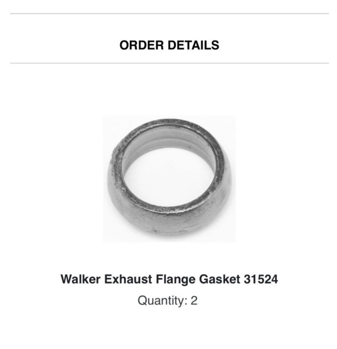

    Was the hardest part of the TRD install getting the connection bolted together behind the ending with the cross over pipe? I installed the TRD set on my engine in about 10 minutes with the cab off. The joint behind the engine looks like it would be almost impossible to get to with he cab on. Any idea where to get the donut gaskets for those two spring loaded joints on the TRD headers?

    It’s a walker part. I’d have to check the part number again.

    If you can find it. That would be great. I have not put my cab back on yet. Not sure of the condition of the gaskets in both flanges. Would totally suck to get it all back together and have a leaky flange gaskets. If I can get some new ones. I would like to change them before putting the cab back on.

    They physically snap on to the male side of the connections so you don't have to worry about holding them in place as you tighten your bolts.

    Thank you, I will get a couple now since it's easy to change now.
