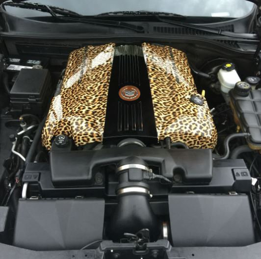

    It's up to you. I think we are all safe here in Taco land. I haven't seen any leopard print hydro dipped valve covers on a Taco yet.
    Luv my yota and GQ7227[QUOTED] like this.
