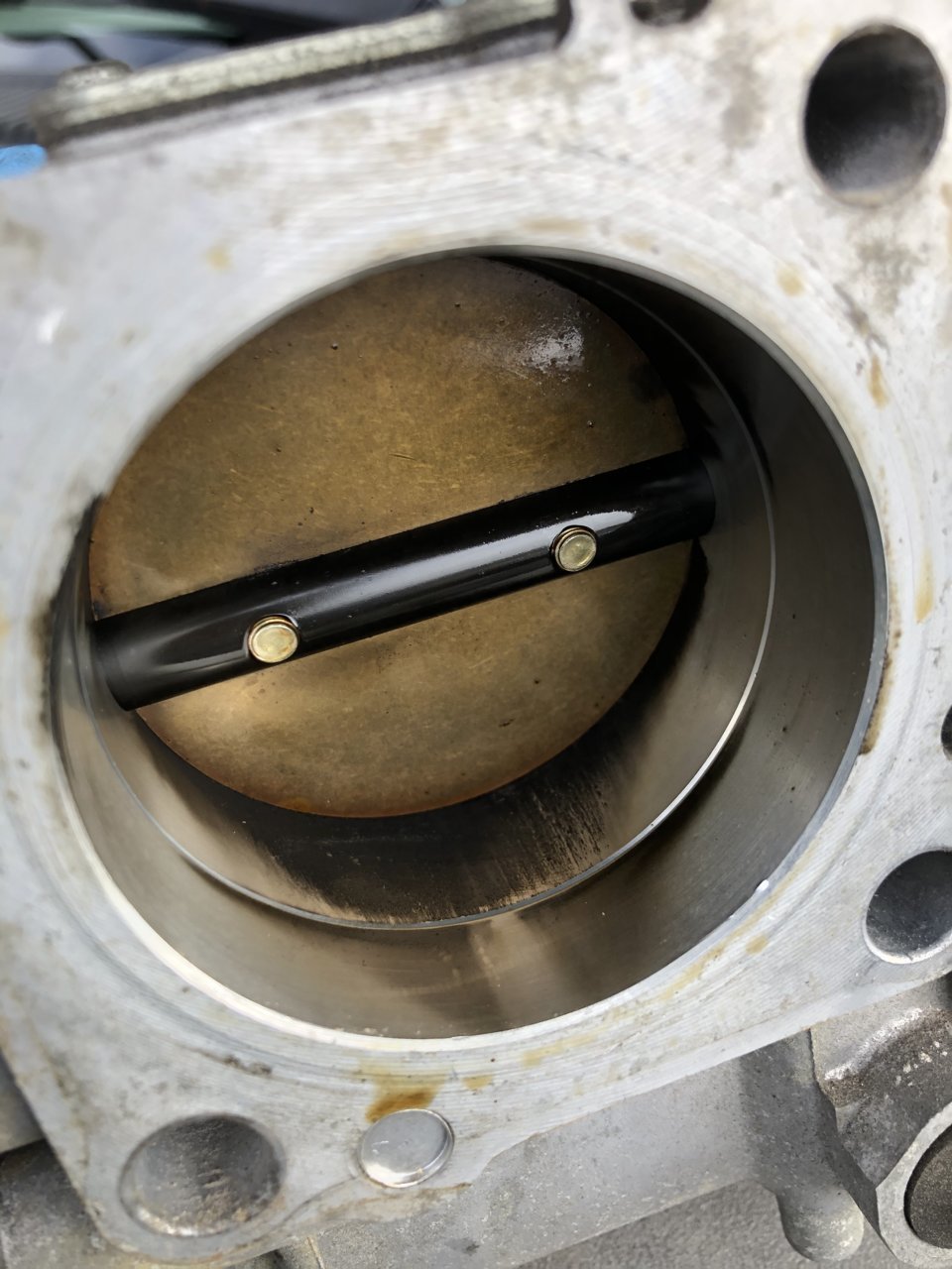

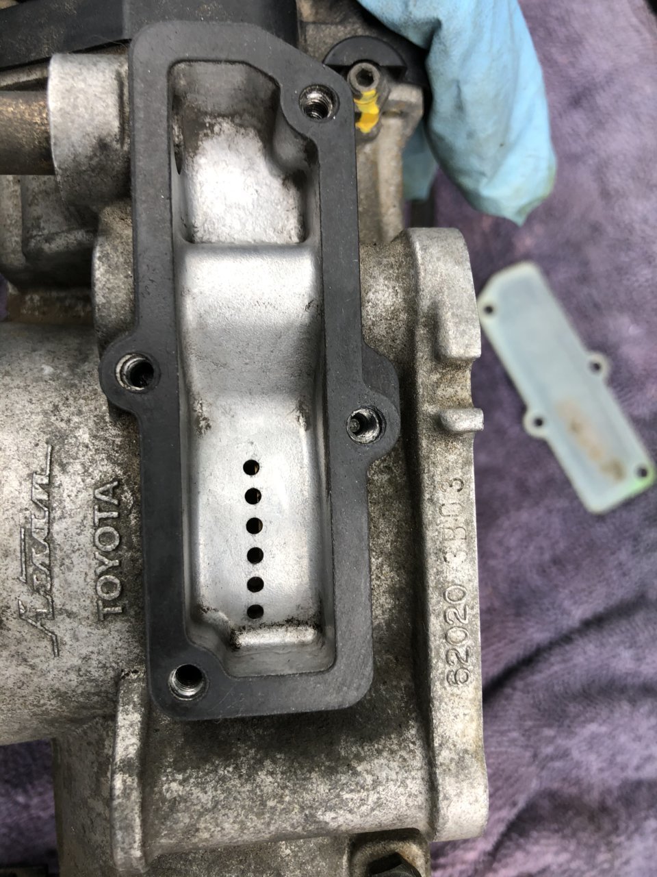

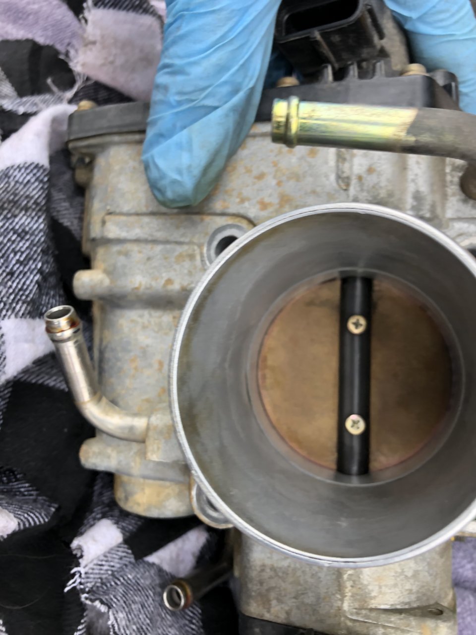

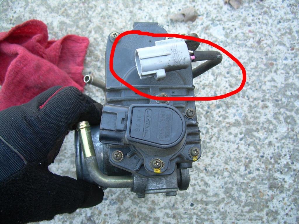

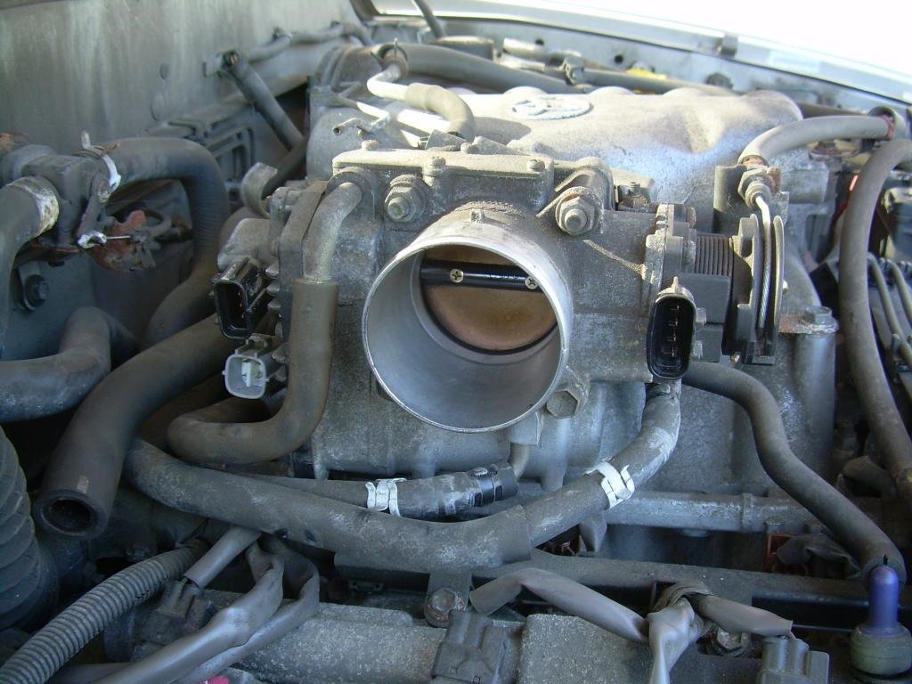

    I just finished. It was pretty gunked up in there but honestly I expected a lot worse. Throttle response is much better and she idles like a brand new truck. Here are some before and after pics. Ordered a new MAF sensor just because the old one does look like it needs replacing.

    If you can cancel your MAF order, do it. If your MAF goes bad, you'll know it and be throwing a CEL code and your engine won't run right. At the very least, don't throw your old MAF away because it's perfectly good.

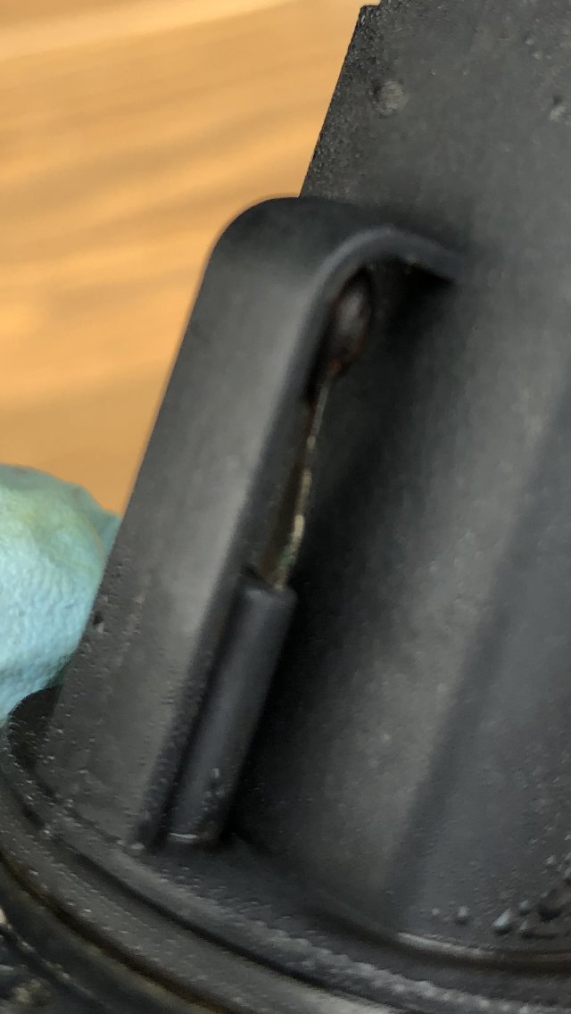

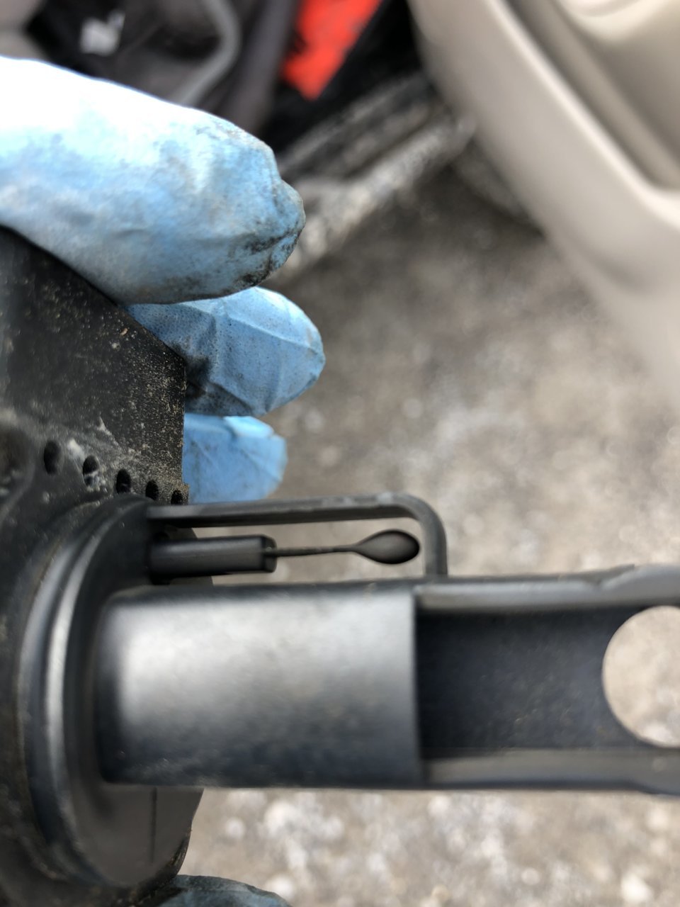

    @QMEDJoe That dark bulb on the side of the MAF tube is the intake air temp sensor, the actual MAF sensor is way up inside the tube. Looks like a pair of little resistors, very delicate. Don't touch, just spray, no matter how tempting.
    If you are aware of this then carry on.

    No shiz? I didn't know that. I'm happy to know that now though? I mean yeah, I think we knew there were additional sensors besides that amber looking bulb thing, but didn't which was which.

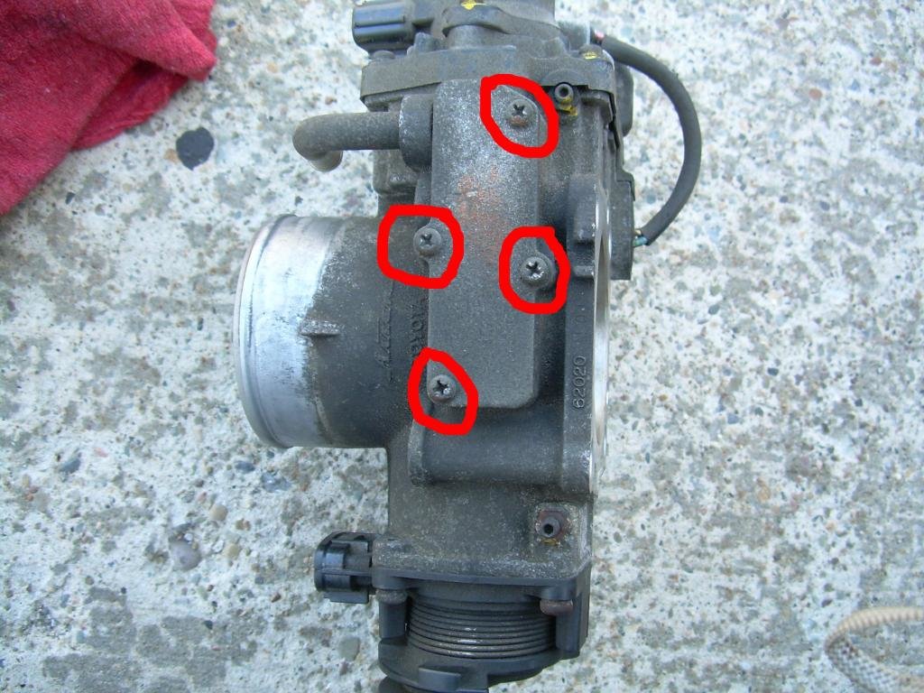

    Wow! What great information. That is exactly like mine. I had no idea that the TB had coolant lines running to it. I gave up on removing the four screws on the top for fear of stripping them. Now I am certainly going to try again.
    Could you define "IAC" and "ETCS"?
    You So Much!
    FTG (Florida Taco Guy):D

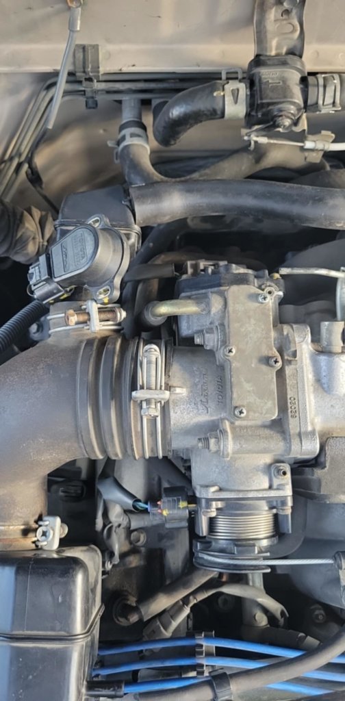

    I know this thread is old but I am having a hell of a time trying to get this throttle body tuned. Anyone have any suggestions? I lost the first 1/4 of my throttle and dont get a response tell about 3k when the physical mechanism open the TB. I saw the above pictures of cleaning the TB and im going to try that. It's annoying the toyota doesn't show this TB on my truck so all the parts they reference are wrong.
