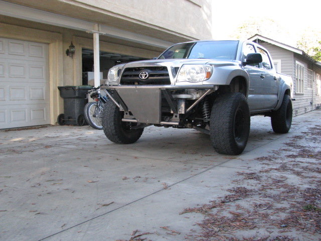

    looking for a bumper?
    I make em

    Now with that bumper you could probably run 3.5" BS no prob. :D
