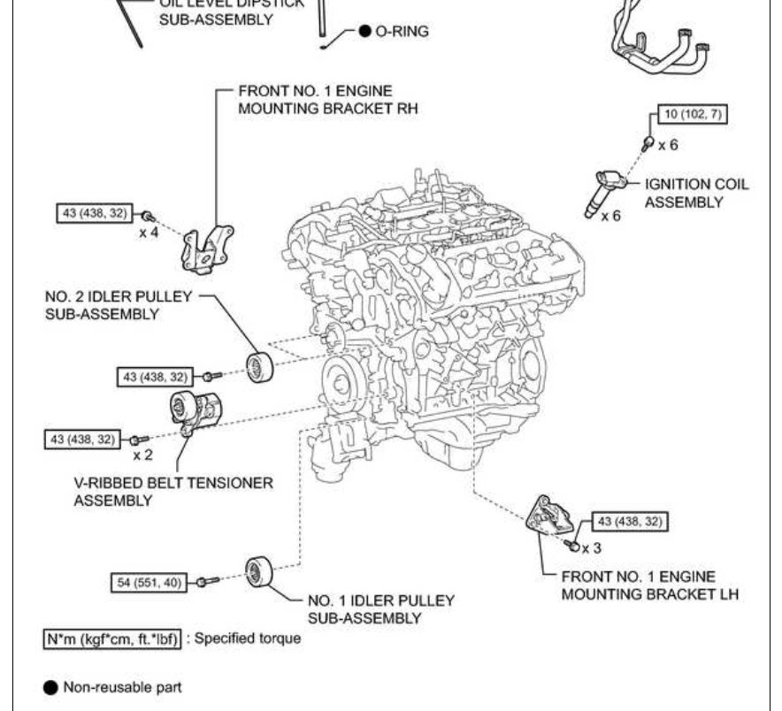

    Anyone know what the torque specs are for the three idler pulleys? I assume they are left hand thread?

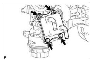

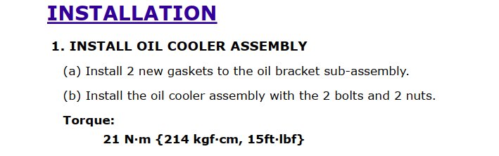

    Also, what are the torque specs for the top four fasteners on the oil filter cooler?
  3. Dec 12, 2021 at 11:47 AM
    GrundleJuice
    GrundleJuice Well-Known Member
    Mar 15, 2015
    #150931
    2,346
    Michigan
    2016 TRD Bro
    [S]Un-Molested[/S] Lightly Molested
  4. Dec 12, 2021 at 11:50 AM
    GrundleJuice
    Mar 15, 2015
    #150931
    2,346
    Michigan
    2016 TRD Bro
  5. Dec 12, 2021 at 12:41 PM
    trdgts
    trdgts [OP] Member
    Mar 24, 2021
    #360479
    17
    Aaron
    16 QS Sport DCSB 6MT
    Thank you!
