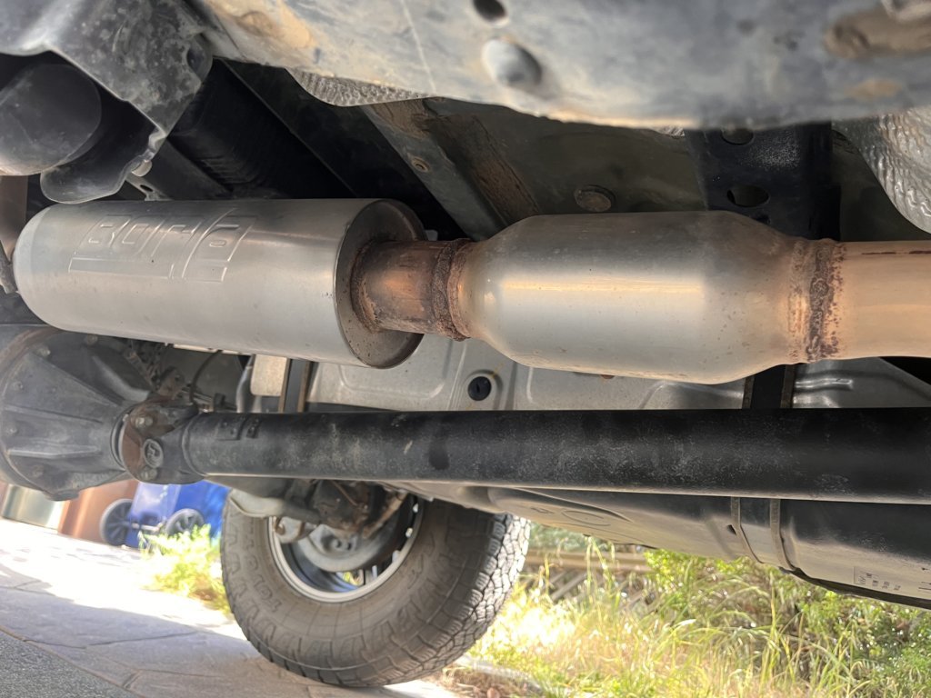

    OP do you know how long the j pipes are? Does it drone at all, even if you’re going up an incline on the highway? Mines got a slight resonance peak around 2200 rpm and it’ll drone at that rpm if I’m going up an incline on the highway, wondering if a j pipe would help and the length needed

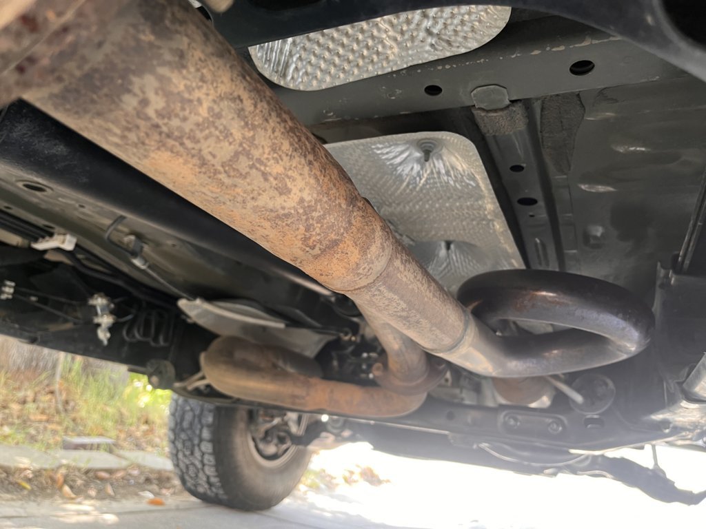

    Thanks, it’s very simple actually, all the piping/cats are stock except the passenger side has a 360 bend in it to match the driver side y pipe length. Id only do it on a 2wd like mine because I’m not sure if it would fit with a transfer case in the way, and 4wds need the y pipe redone regardless due to the way it’s routed under the crossmember reducing ground clearance. The muffler is a small borla bullet #401392 and it has a small vibrant resonator in front of the muffler, which I plan to swap with a Helmholtz resonator because right now it has a loud resonance (drone) between 2-3k rpm’s and the exhaust gets too quiet after 3 k rpm, I’m hoping the Helmholtz will cancel out the 2-3k drone and deleting the vibrant resonator will make the exhaust louder in the higher rpm’s IMG_4934.jpgIMG_4935.jpg
