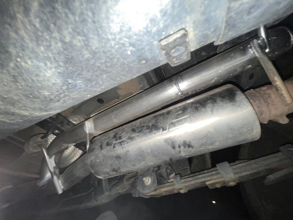

    Well after installing the Helmholtz j pipe and chopping the exhaust tip off, it sounds almost exactly like yours OP https://youtube.com/shorts/QaqSKmVaGk0?si=VbpDUcW4OCI_AB4V
    IMG_4979.jpg As far as the j pipe/Helmholtz goes, it’s a magical little device! Just took 2 tries to get the pipe the right length to kill my 2300rpm 118hz ear splitting drone. Anyone considering using a Helmholtz to kill drone make sure to calculate with taking into account the speed of sound with the exhaust temperature (my measurements led to about 275 degrees f), not room temperature, that’s where I messed up at first and why it took 2 tries to get the pipe the right length. And use a frequency measuring app on your phone, it eliminates the confusion of finding the exact rpm and number firing events. But no more drone!! And I don’t care what anyone says, exhaust tips change sound. After chopping it off sounds so much smoother and less obnoxious sound peaks

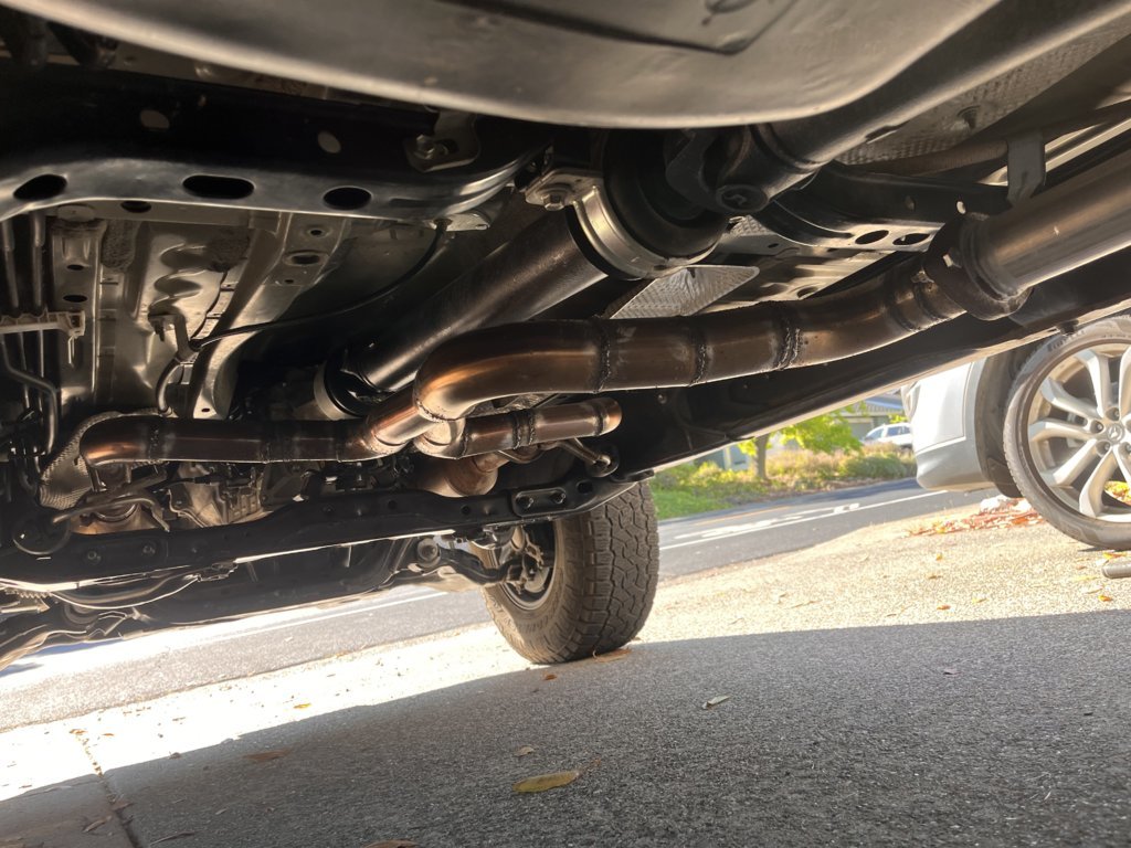

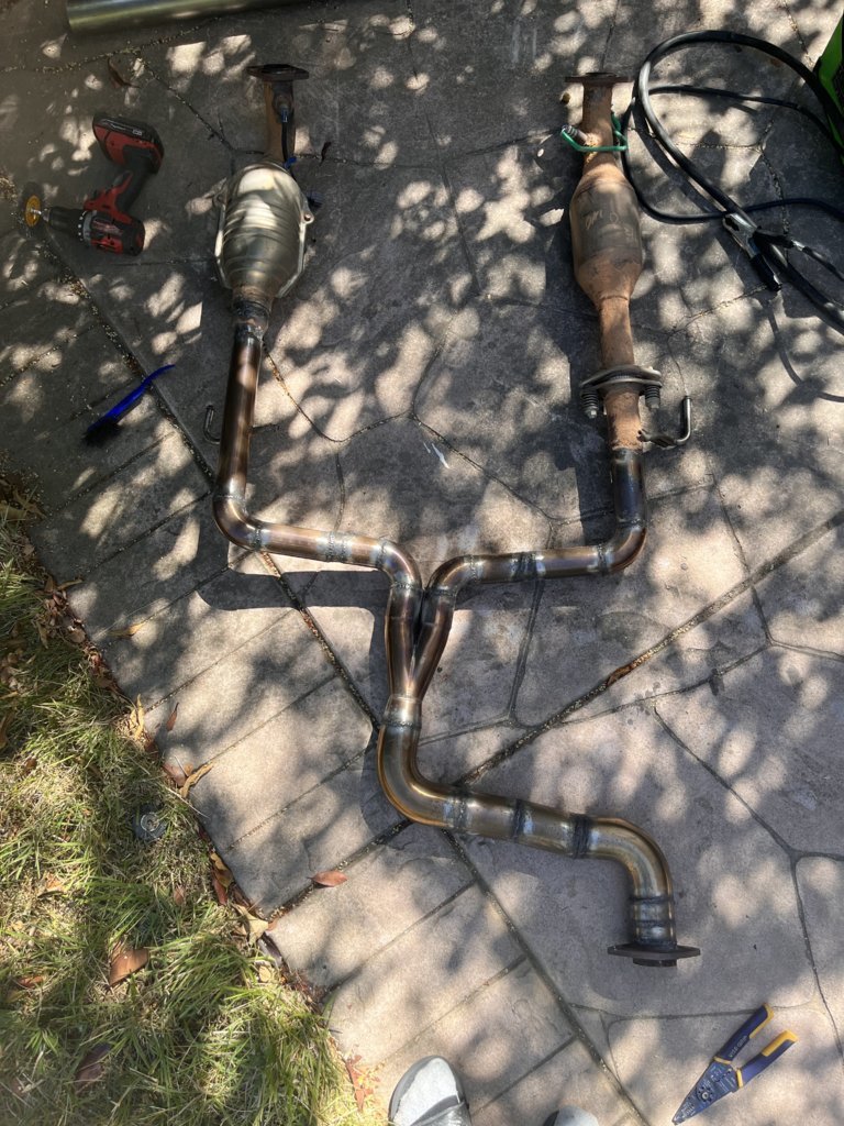

    IMG_5196.jpg IMG_5197.jpg Anticipating a future 4wd conversion, I decided to just build my own equal length y pipe behind the factory secondary cats that would allow room for a transfer case. Just got some 304ss piping, bends, merge collector and a harbor freight flux core welder. I’m not the best welder but it holds and doesn’t leak. Could have gone with the dirty deeds y pipe but I saw this as an opportunity to get my hands dirty and learn a skill that would save me money in the long run. Because of the well designed merge collector I used, it sounds a lot smoother and less droney than it didn’t before with just the loop setup. I’ll try to get some sound clips later on. Love how it sounds though!
