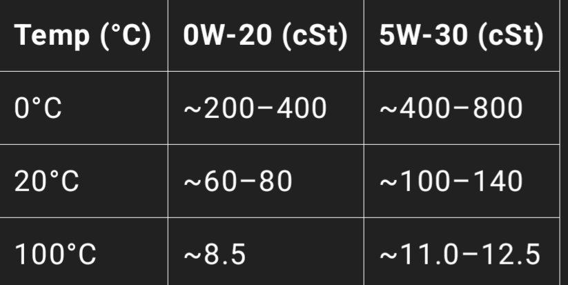

    The 5w is fine as long as it's not used in cold climates. There is based on the SAE J300 testing which states 5 weight engine oil is good down to -30c (-22F).
    Once at operating temperature, the 30 is going to be far thinner than the 5 was cold. In other words, on the freeway with a warm engine (100c), the 30 weight oil is 50% thicker than the 20, but still only a faction of what the oil was when the engine was cold.
    If you live in a very hot climate, It could be beneficial to increase for the summer months. Are you going to notice a difference in longevity of the engine? Probably not. Are you going to notice a decrease in fuel economy? Probably not.
