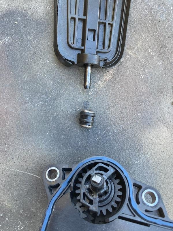

    Another broken ACIS. Three weeks ago I started misfiring on 5, then 1 and 3 with random misfire codes as well. Tried plugs and coils. Replaced the camshaft position sensors on the passenger side and the misfires immediately stopped. Yesterday I started misfiring on 3 again at high rpm. Double checked the plug and coil and lp fuel injector. Nothing. Pulled the intake to check the hp injector and heard the valve bouncing around in there. Never did find the bushing though, can only imagine where that went. I removed the valve and drove the truck around, seems fine without it. Ordering another manifold but I wonder how much difference it actually makes.

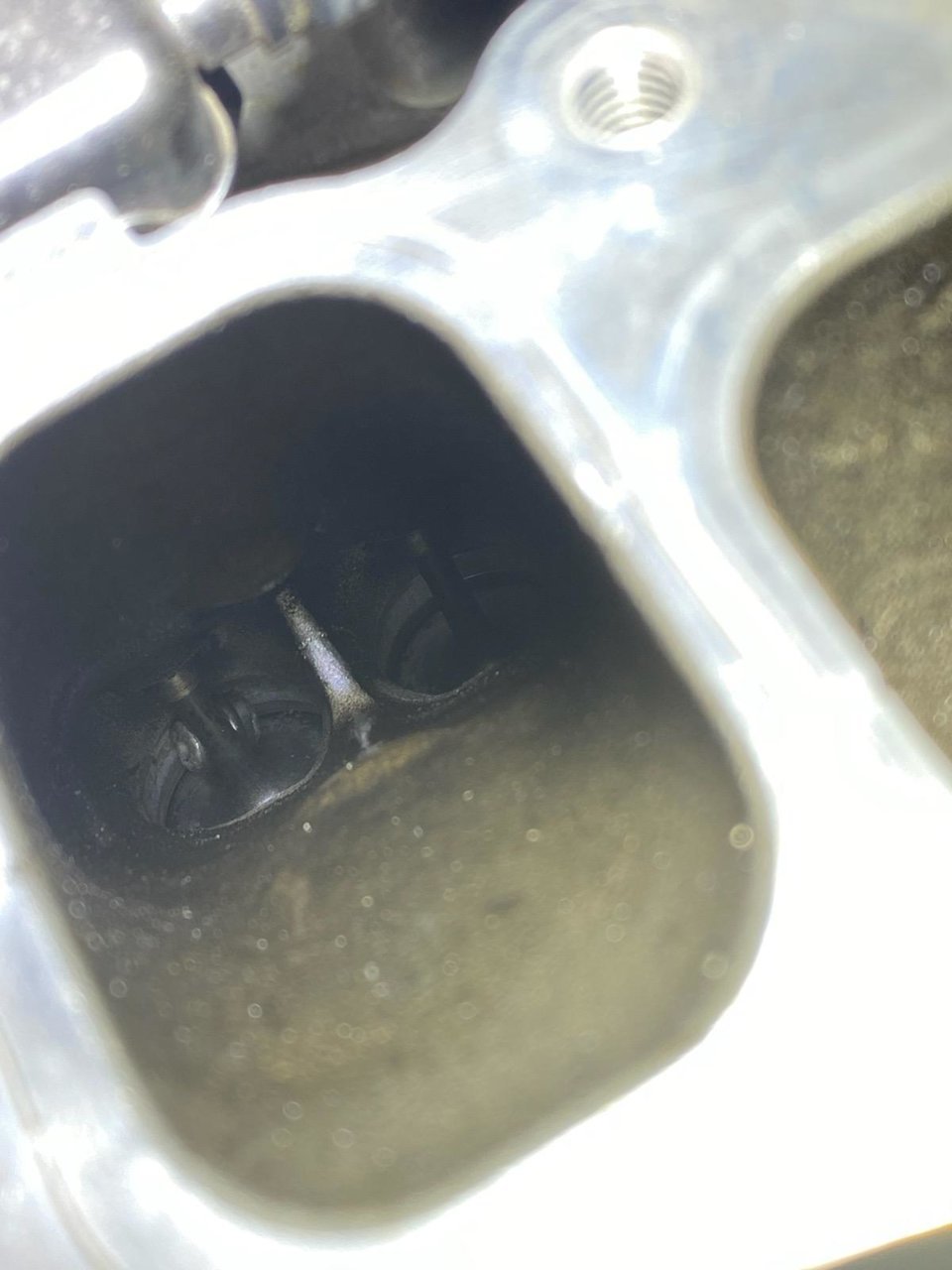

    Amazon has cheap flexiable cameras. I would look at the valves while replacing the manifold.

    I have a scope and checked them, nada. My hope is that it dropped out when I pulled the manifold.

    More than likely, the bushing stayed in the manifold itself. You can always cut apart the old one, and check that way...or run a bore scope into the old one and try to see it that way.

    You can actually see the tops of the valves in the lower intake with just a good flashlight. They aren't far down the runner, and it a pretty straight port to the valve.

    Exactly what we did today, and there was the bushing on top of the intake valve that kept giving us the P0305 error. New Plenum at $643 should be a "no charge" replace from Toyota!

    That's insane, that's exactly where mine was too...but the rubber part was already gone on mine. Consumed and burned up by the engine most likely.
