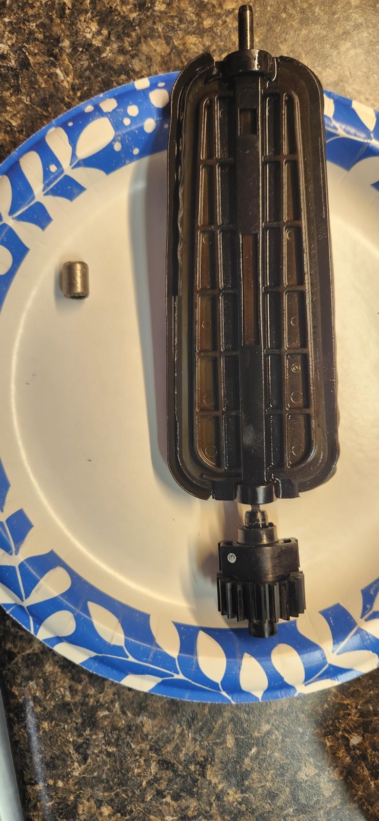

    Found mine today. Fell apart on the way home, cylinder 1 misfire. Removed the gear, flap and shook out the bushing. It been bouncing around the intake. Put it all back together without it. Truck runs fine without it. No codes, very smooth through the rpm range. Truck has 81,000 miles. Also did plugs and replaced coil #1 since I already ordered spares anyway. BE SURE TO GET THAT BUSHING OUT!!!

    Get all the parts out, reuse the intake. No codes without these parts.

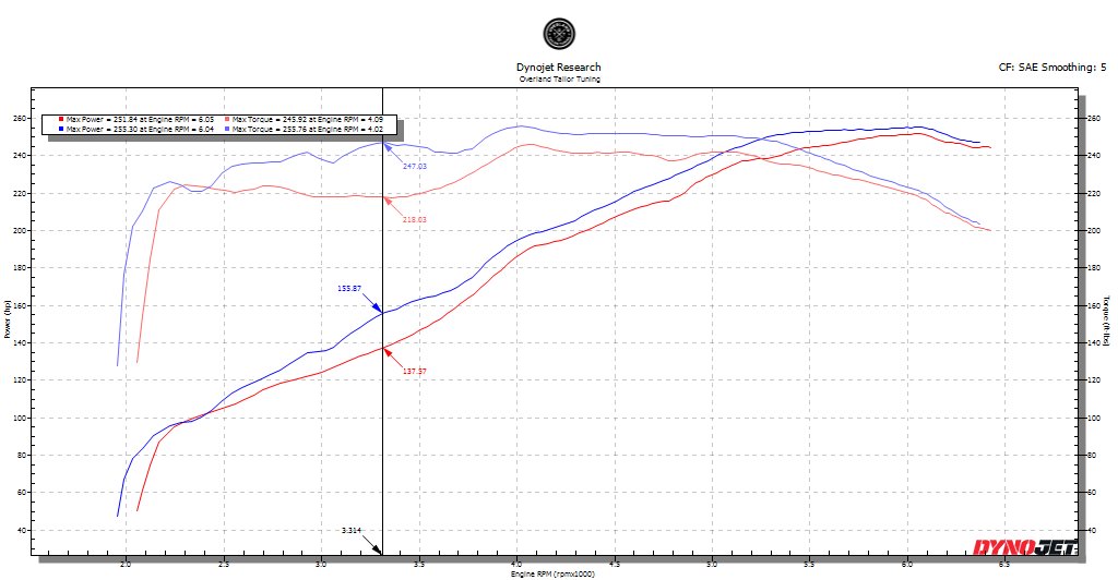

    Not 100% apples-apples but here is one 3G (same truck/same day) on two different calibrations. One with "normal" ACIS operation and another that does not utilize ACIS where it's resonant benefits are observed. For this comparison, I'd only look at the data below 4K RPM, as anything after that would not be related to ACIS operation or lack thereof.
    There is a pretty substantial torque loss without the ACIS system.

    This proves the lackluster power when I drove it without the flap in there. I did do that for a few days, but it felt lethargic in throttle response and I found myself putting my foot into the throttle more to pull out and even just when driving around town.

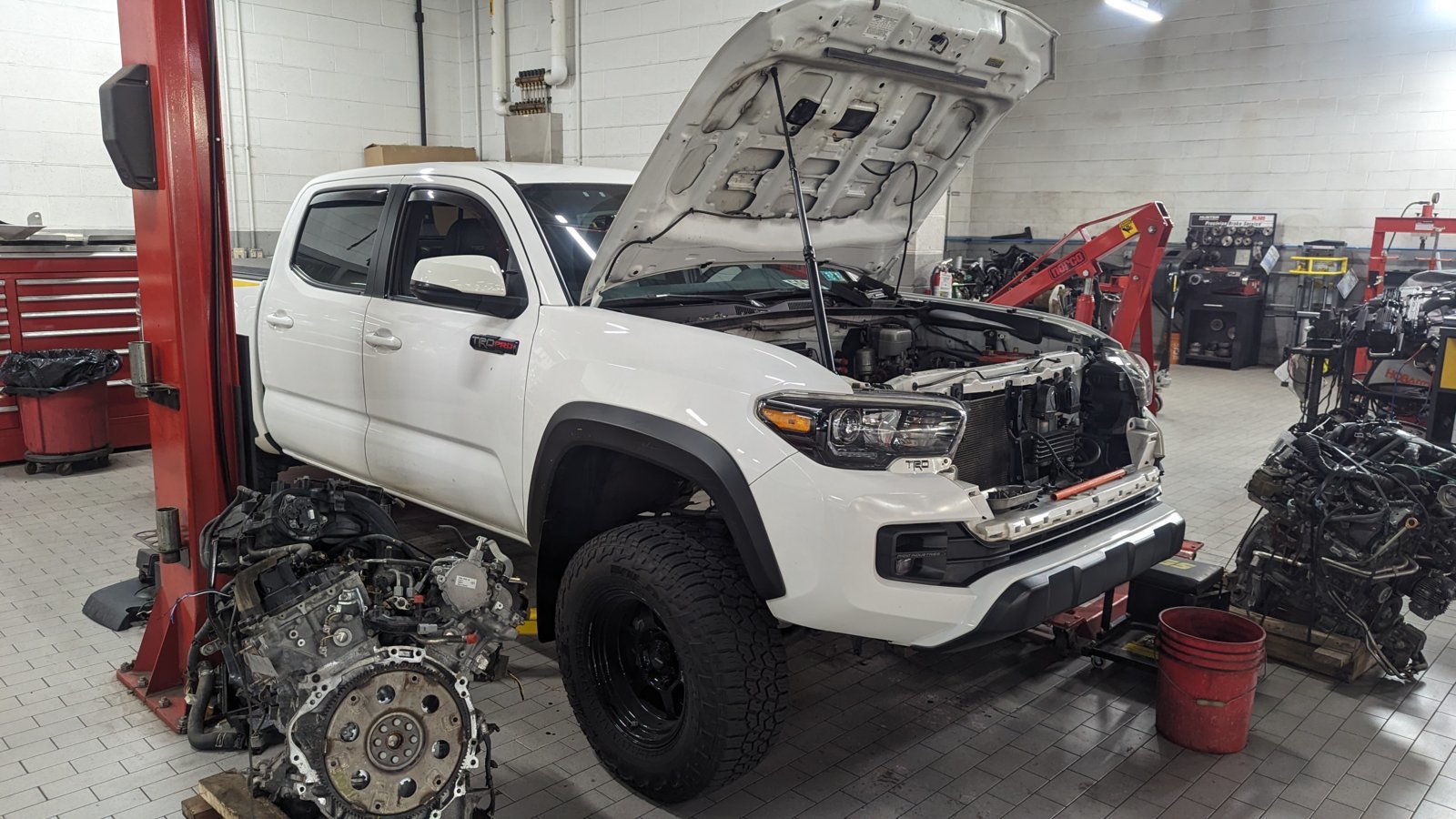

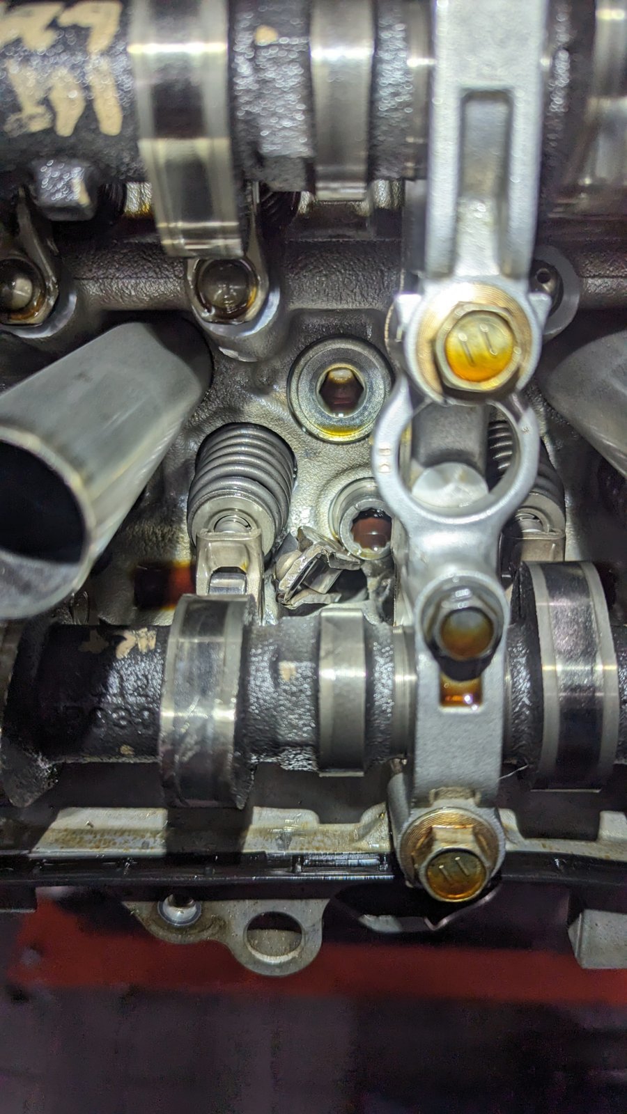

    Man, you thought I was griping about $600 bucks for that intake.....you should have heard me when I had to shell out $12,868 to put an engine in my truck because it suffered a valvetrain failure at 100k and sent cam follower needle bearings into the oil pump, and then wiped the bottom end out.

    So did you have both ACIS and valvetrain failures on the same engine?
