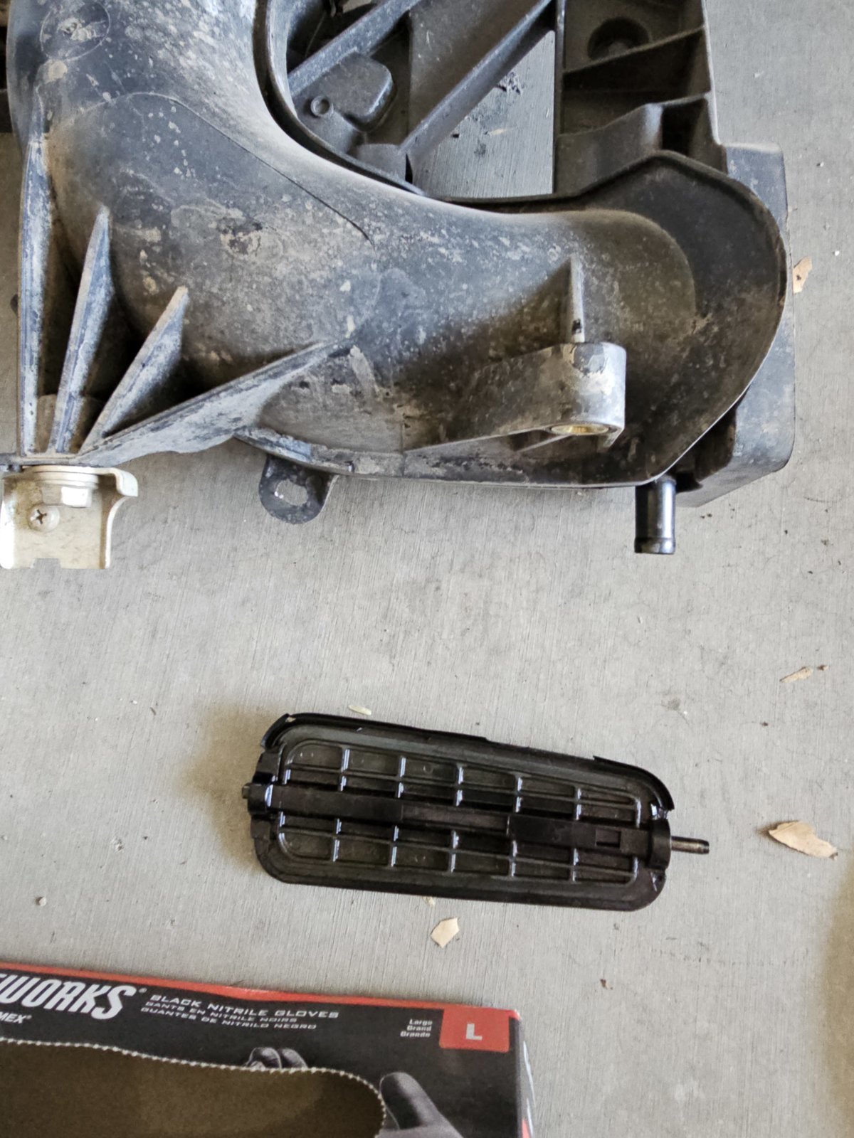

    I just pulled my intake manifold for this same issue, cylinder 3 misfire at high rpm under load. It happened to me on the highway, passing a semi. Started misfiring and went into limp mode. Thank you for posting this on the forum!

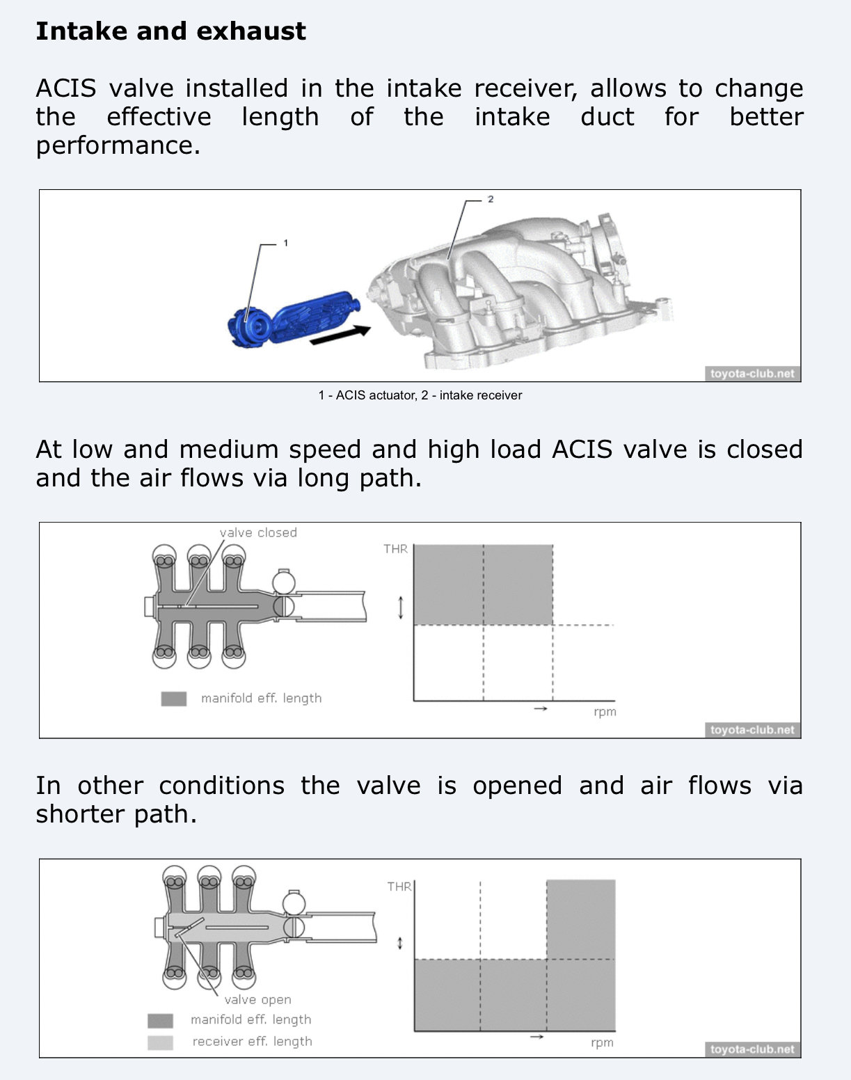

    From what I recall, removing the flap will result in less torque down low because I think you’d be in short runner mode all the time. I might have that backwards. Either way, you’d notice a loss of performance either down low or up high and it would be noticeable. I drove around with mine unplugged just to see what it would do and I was not a fan. I’m not sure which version that resulted in though.

    Looks like its metal. I have a long telescoping pen like thing that has a magnet on the end that might have done the trick also.

    Unplugged would keep the valve closed.

    Do you recall if valve closed is short runner or long runner mode? It felt like short runner mode to me.

    Long runner for torque is usually how they are all set up.

    I found the 2GR-FKS document I had referenced in the last. Closed position is supposedly the long path for torque, and as you said the default for unplugged was closed. Odd, from what I remember I felt like I lost my low end. Any chance the forces of air flowing through there could open the valve? I’m not sure how much resistance there is in the motor to keep it from opening if unplugged.
    Doesn’t really matter, not going to run it that way, just curious, in case the future calls for it as a temp solution.
