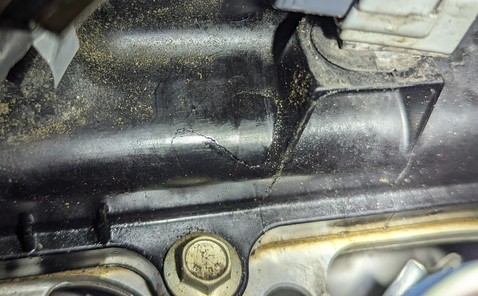

    Ok...here's a new one.
    Who's ever had their cam cover on their 3.5 randomly crack and start leaking oil?
    I smelled hot oil, and saw smoke......then noticed the passenger side of the cross member was wet, and oil was on the exhaust.
    I swear it looks like it was hit from the inside, but I have no clue how that would be possible....the engine is running great.
    Thank gosh I keep a stick of two part epoxy in my glovebox.... hopefully that holds until I can figure how and why this happened.

    If something hit it, the piece would not be flush. Since it is next to a feature, it might just be a molding flaw.

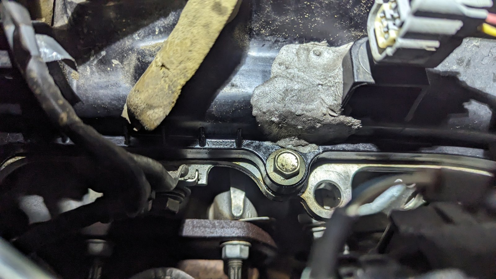

    Update
    The patch is holding quite well. Not leaking anymore. I've used this stuff to patch exhaust manifolds, so I'm confident it will hold up on the cam cover.
    Next up, finding and pricing out a new cover.

    Agree. Something came lose inside. Better open sooner than later

    I have no clue what it would be though. If it was valvetrain, that would absolutely be causing a misfire.....and it's not. Its running like a sewing machine.

    That was a long time ago....I would think that it would have started leaking long before a week or so ago. That intake was actually super easy to take off...but, anything is possible. I could have wacked the cover with a ratchet or extension and cracked it and never even knew until now.
    I would say it was a better chance I would have done that when I changed the plugs though. That's right in that area.

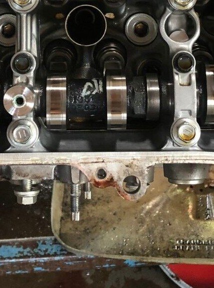

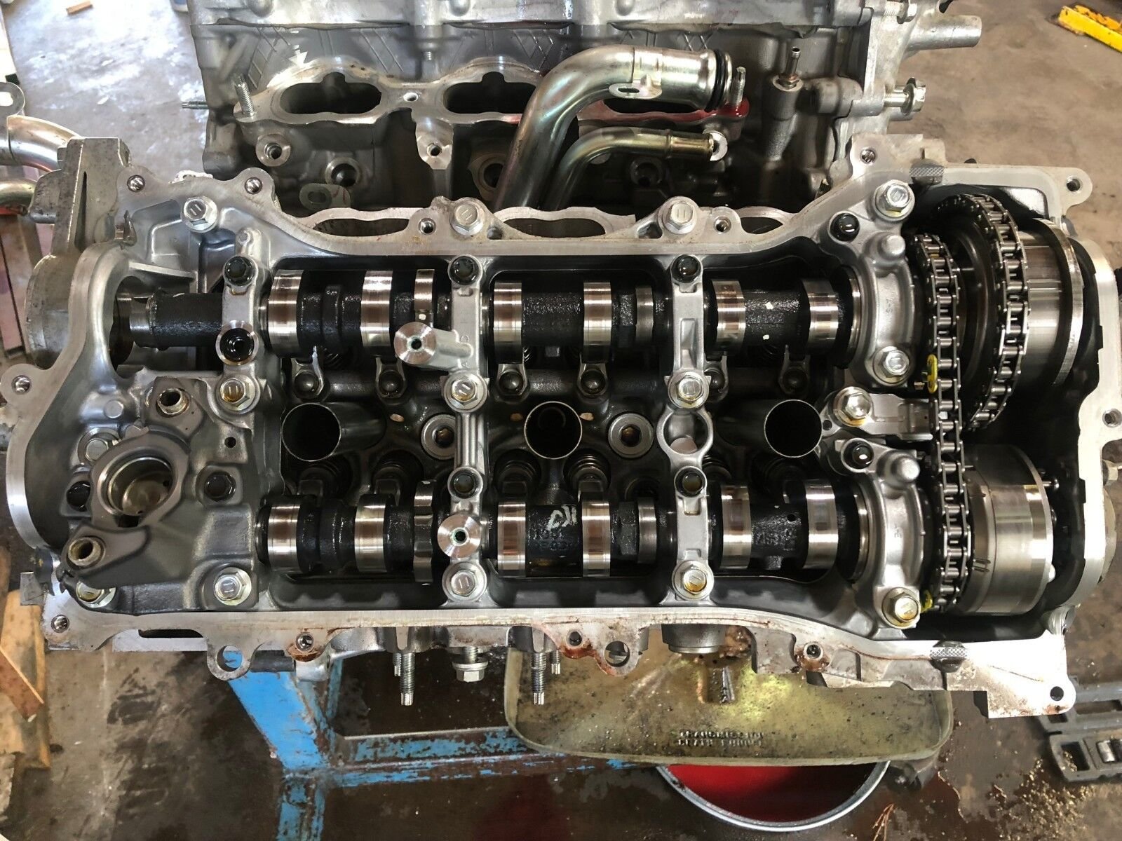

    Ok, here's the inside of the right cylinder head. This is picture of a used head I found. You can see the valve cover bolt hole next to the casting hole, right where my cover was cracked. There's nothing there that could have cracked it...unless the cam had a failure, which is unlikely as it runs fine....or a rocker came loose from under the cam and valve, also highly unlikely due to the drivability issues it would cause. So I'm kinda stumped until I actually take it apart, or I actually did damage it myself and I never realized it...and it took a while for the crack spread to the point it leaked.
