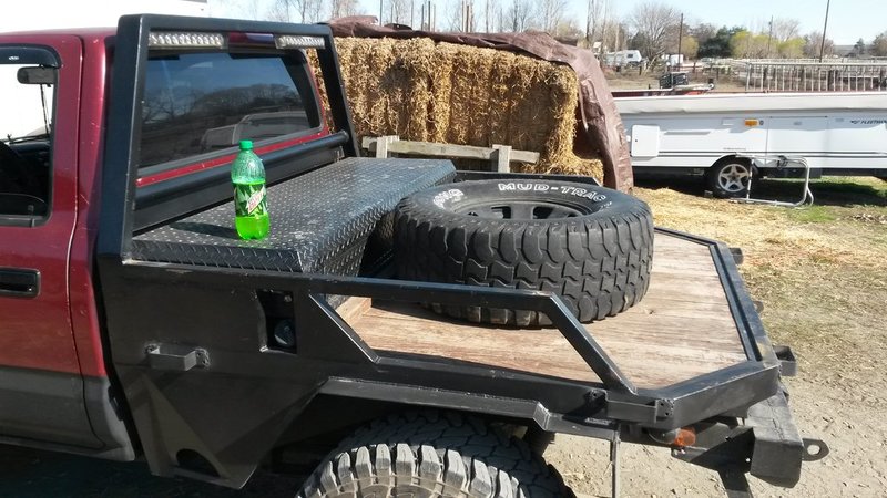

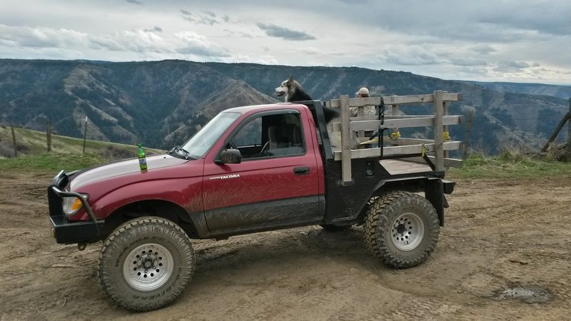

    Flatbed came with the truck, it's not too bad. Tool box is sunk down, spare bolts down, I welded the brackets for the wood racks for hauling my dog around, since she won't stay on a flatbed.

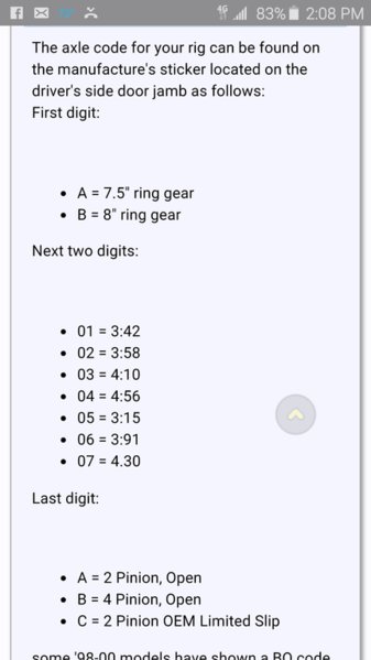

    According to my door, it says B02A. That chart would make them 3:73s...the chart I looked at and saw the other day said 3:58s

    The above chart is in first gen Tacoma sticky section, OEM gearing...that says 3:58s

    The door sticker/code charts are historically not always correct. Best bet is to check what you have using the method Clay_916 mentioned in post #10.
