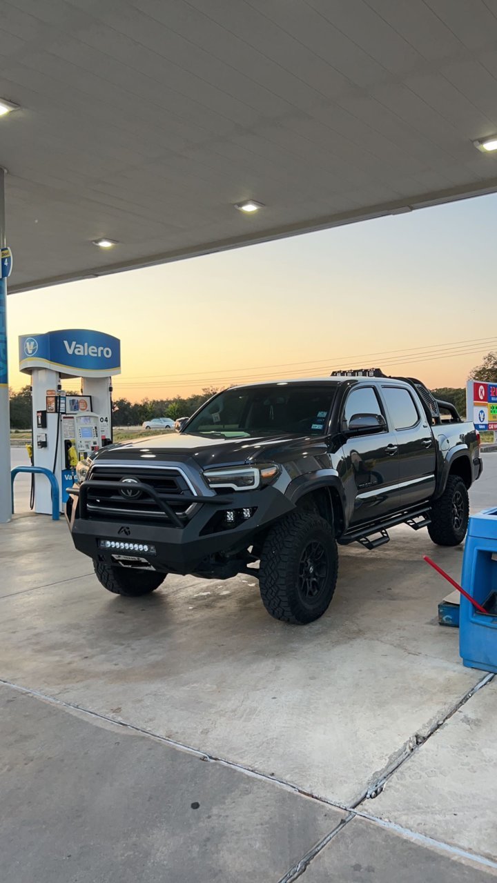

    Here’s my tacoma rn in case you were wondering

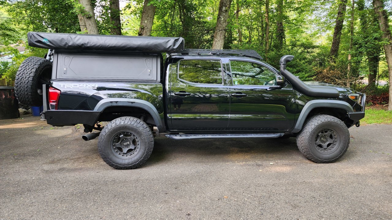

    I have the equivalent setup as far as ride height goes in 16in rims, General grabbers atx in E rating. Around town about 17mpg. Best mpg is at 47mph, don't ask me why, and I get about 18.5. On the highway at 65mph I can squeeze out 15.5-16.5. Anything over 70mph and it's 14.5-15mpg. Also throw in some highway hills and its around 14mpg. I also have an aluminum bed cap though and that recouped about 1mpg.
    You have to start thinking about the weight you carry around too. As you can see, I have bumpers, sliders, roof racks, etc.
    Edit: also you need to consider what a 3.5in lift is going to do to the rest of your drive train. The general rule of thumb is nothing over 2.5/3in if you're keeping the CVs and stuff stock. Not gonna play well and may cause premature wear and failure.

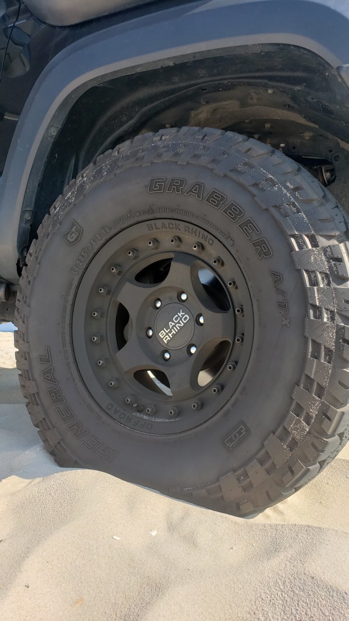

    What wheels are those?

    Black Rhino Bantams:
