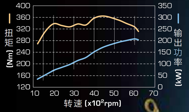

    Here is what the torque profile may look like (potentially very similiar 7GR). Notice the small bump in torque just above 3K RPM, and the big bump going up to 4K RPM. If the 2GR's profile is similiar, it could explain what you are feeling.
    From: https://www.tacomaworld.com/threads/2016-tacoma-dyno-torque-hp-crve.391512/page-6#post-11149837
    Regarding the RPM hold after shifting from 1st to 2nd gear...I am really confused. You have the MT...how can the transmission hold the RPMs at the same (higher) level after you have switched gears and left the clutch out without slipping like mad?

    Wow! Thanks so much for all of the feedback! Every reply was very helpful, and yes, it feels exactly like hitting the power band on a two stroke. The BMW I just came from was designed with a VANOS system and had a little bit of a power band surge as well, so I had suspicions that it could be the variable valve timing. After seeing the torque profile, it all makes sense and that graph is essentially what I feel in the seat. Once it hits, it definitely gets with it, but I just wish I could have that power all the time. As mentioned earlier in the thread, I do experience this more at 3/4s throttle than WOT. In regards to the RPMs staying high while shifting, the rev hang is what I was referring to.....nothing to do with the transmission, just the RPMs sometimes stay up momentarily with the clutch engaged and no throttle being applied.
