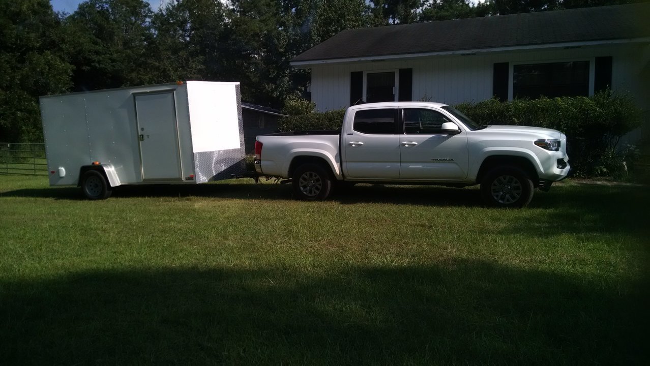

    You ain't the only one. Pulls 4,000 lbs pretty good. IMG_20170805_172322489.jpg

    Me thinks 4000 lbs is too much for that single axle trailer. :duel:

    That's trailer, contents, and what's being carried in the truck.I should have been more clear. :facepalm:
